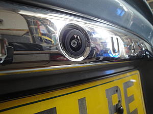

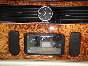

I have a Garmin sat nav fitted in place of the original sat nav and a Garmin reversing camera fitted in the boot finisher. They communicate by Bluetooth and I've never had a hint of any electrical interference to the radio, etc.
Attached Thumbnails Wire routing question from boot to dash-dsc03123.jpg   Wire routing question from boot to dash-dsc03085.jpg
