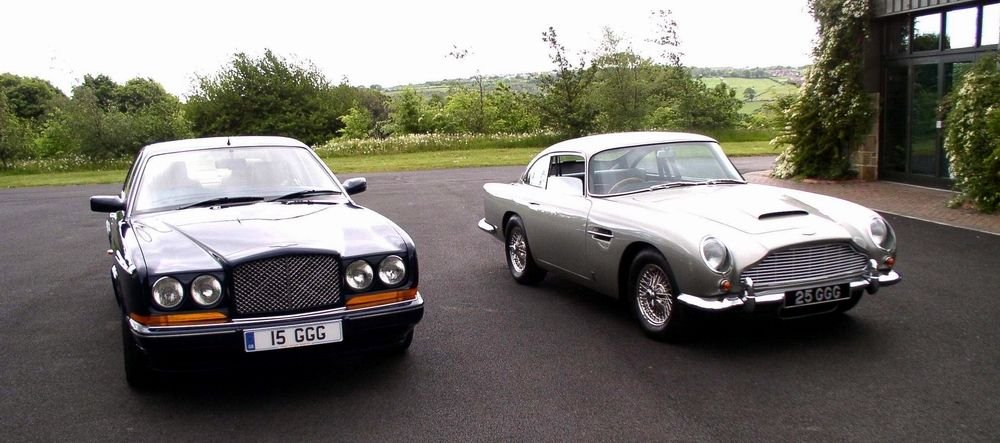

Graham,
Please tell us about that gorgeous Aston Martin that you apparently had at some point in time. How long ago, how enjoyable, pros and cons, etc....

Originally Posted by Jon89
Graham,
Jon,
I had the DB5 from 1978 to 2006 and when that photograph was taken owned both it and the Bentley Continental R next to it. A succession of Jaguars throughout the period served as daily transport.
During my ownership the Aston had two engine rebuilds and a total restoration. The new wire wheels with stainless steel spokes from MWS in London gave none of the loosening and breaking problems I'd had with chromes steel spokes.
Unfortunately it went from a vehicle I could use as a daily driver to one that literally could not be out of sight unless in secure storage. This was the downside of the tiny production number (1024 DB5 Coupes) and values going stratospheric. It also prompted my decision to sell.
The DB5 looks better than it drives. Originally on crossply Avon Turbospeed tyres, the rear breaks away easily and frequently. Radials improve it but the breakaway is less gradual. Steering is heavy and the five speed gearbox (a ZF transmission originally designed for a German truck) awkward because fourth to fifth gear is a dog leg change. That being said, it was a surreal experience to drive as it always attracted attention and huge respect from other drivers. I was never cut up in traffic.
I never regretted either the purchase or the eventual sale. Similarly I loved my E-Type in the early 1970's (a slightly better performer) but wouldn't want one again now. Cars have gone though seismic shifts in design since the sixties and the once magical performance seems sluggish by modern standards. I suspect many buyers will be infatuated with the looks of these magnificent cars but then very disappointed with the driving experience.

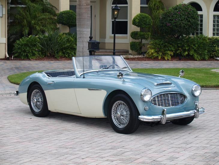

My first car was a 59 Healey 100-6 and its painted wires were never a problem. I started having problems with the E type, not bad,
but just needed a watchful eye on tightness.
Old Nov 21, 2018 | 10:12 AM
Likes: 17,009
Those AH's were a superb monster. A very rare sight over here nowadays.
As I recall, PAINTED were always more robust than CHROMED because the chromium plating process weakened the spokes. This is probaboly ewhy I found stainless steel spokes to be an improvement.

I didn't realize the AH had painted wires. I have seen wires supplied by a company in California for the Kit car industry that look pretty dependable. Not sure if those are the Daytons or not. They are all bolt-ons and seem to be pretty durable. I know a couple of guys who have them on Cobra kit cars. They wring them out pretty well with out any bad results so far after a couple of years usage. As for cleaning, they just spray them down with heavy duty purple foaming, hit them with a high pressure water hose, and seem pretty happy with the results. Of course these are $35,000 plastic repro Cobras. One does have a $15,000 engine in it. Go figure........
