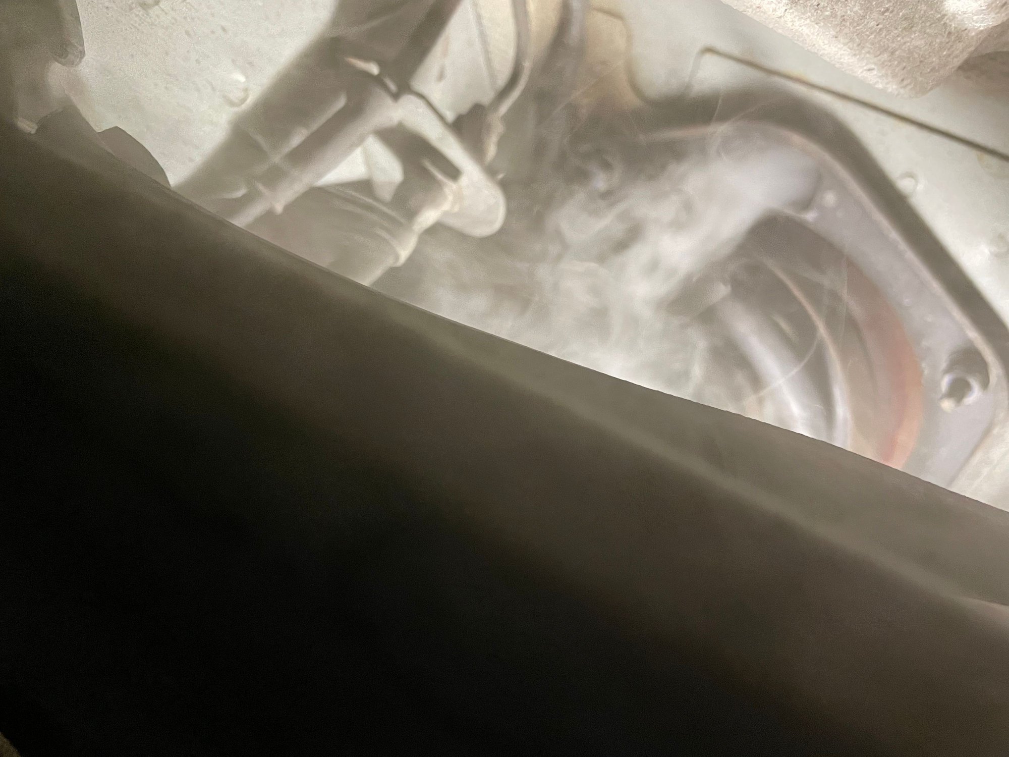

I was getting the check gas cap message and all the readiness monitors had passed except for the evap readiness. Eventually the car gave I believe a P0455 error code. I replaced the gas cap and cleared the codes. The gas cap message has come back. I did a smoke test through one of the tubes at the purge valve. I had expected a bad hose around the canister (based on other forum messages), but smoke come pouring out at the rear passenger (RT) springs. I'm new to smoke testing and only applied smoke to one of the tubes. Is this normal, or what should I check? I couldn't tell if any smoke was coming out near the canister in the back as so much was coming from the spring area. This is a 2002 XK8 convertible (NA).

Sounds like a failed (open) CCV or piping for EVAP monitor.
To do a proper CCV test you need to have the CCV closed.(it is open at the 'filter' at the end of the pipe in the spring/damper mount hole)
WDS/IDS can do this for up to 30 minutes while leak tests are being performed.
You can manually block the pipe at the CCV?

Thanks for the reply. I don't have a WDS/IDS setup. I can see about blocking the pipe. For now I have given the garage space where I can work back to the wife.
