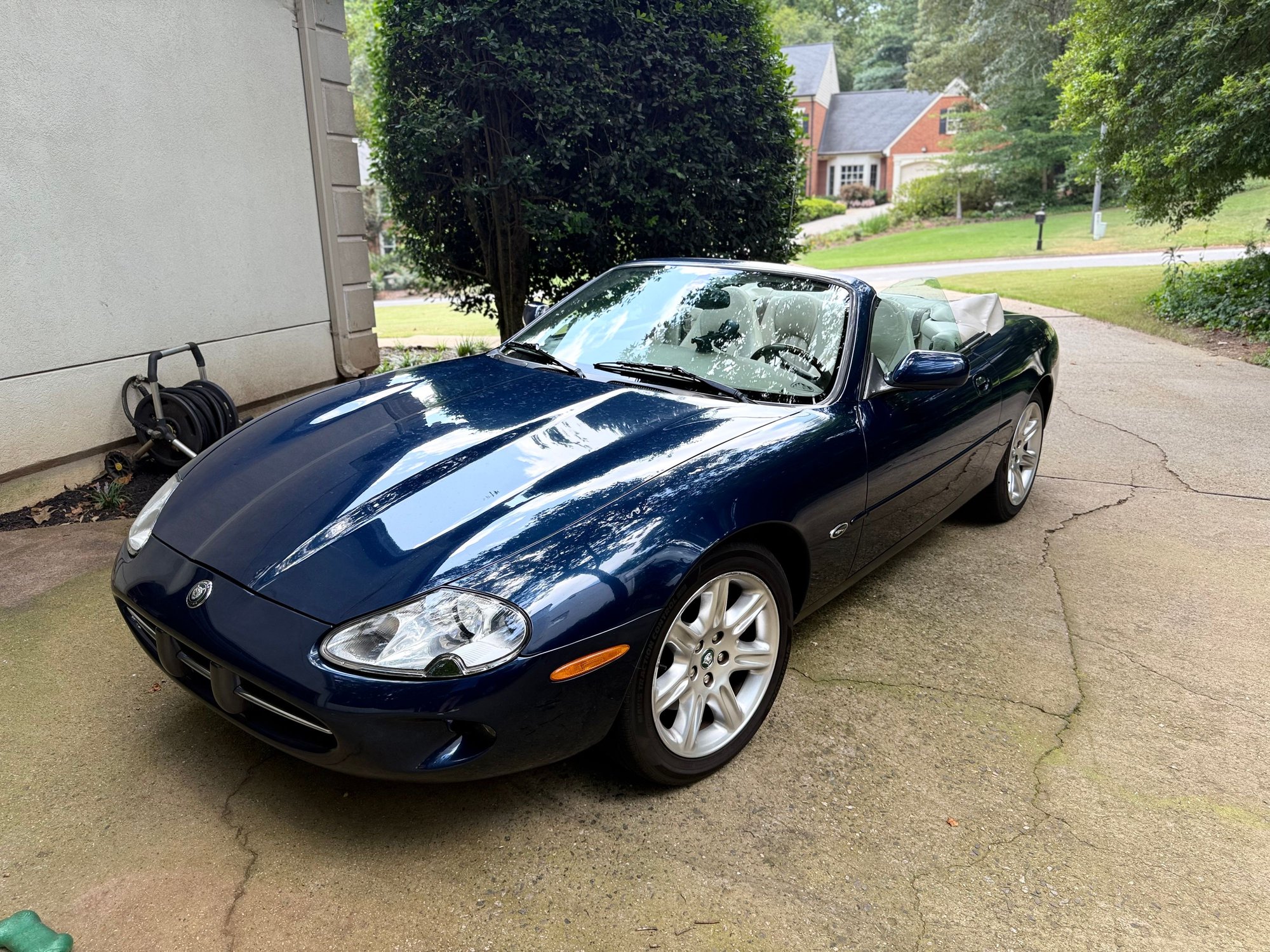

photo for sexiness 😮‍💨

No matter, it is beautiful.
