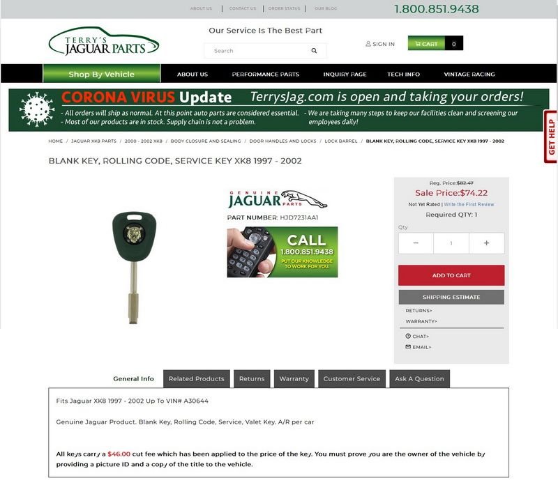

You can get either a blank to have cut locally or a cut Valet Key from Terrys Jaguar Parts but you may lose enthusiasm when you see what it costs.
https://www.terrysjag.com/product/HJD7231AA1.html

Curiouser and curiouser.
Jaguar's price for the black key is almost double that of the green (UK £72.88 and £40.48 + tax) . I imagine it is something to do with the cost of the pigments
I know which I will choose if I need another key...

I noticed that too on the Jaguar Parts website. Don't forget all the extra machining required on the end of the Master Key.
