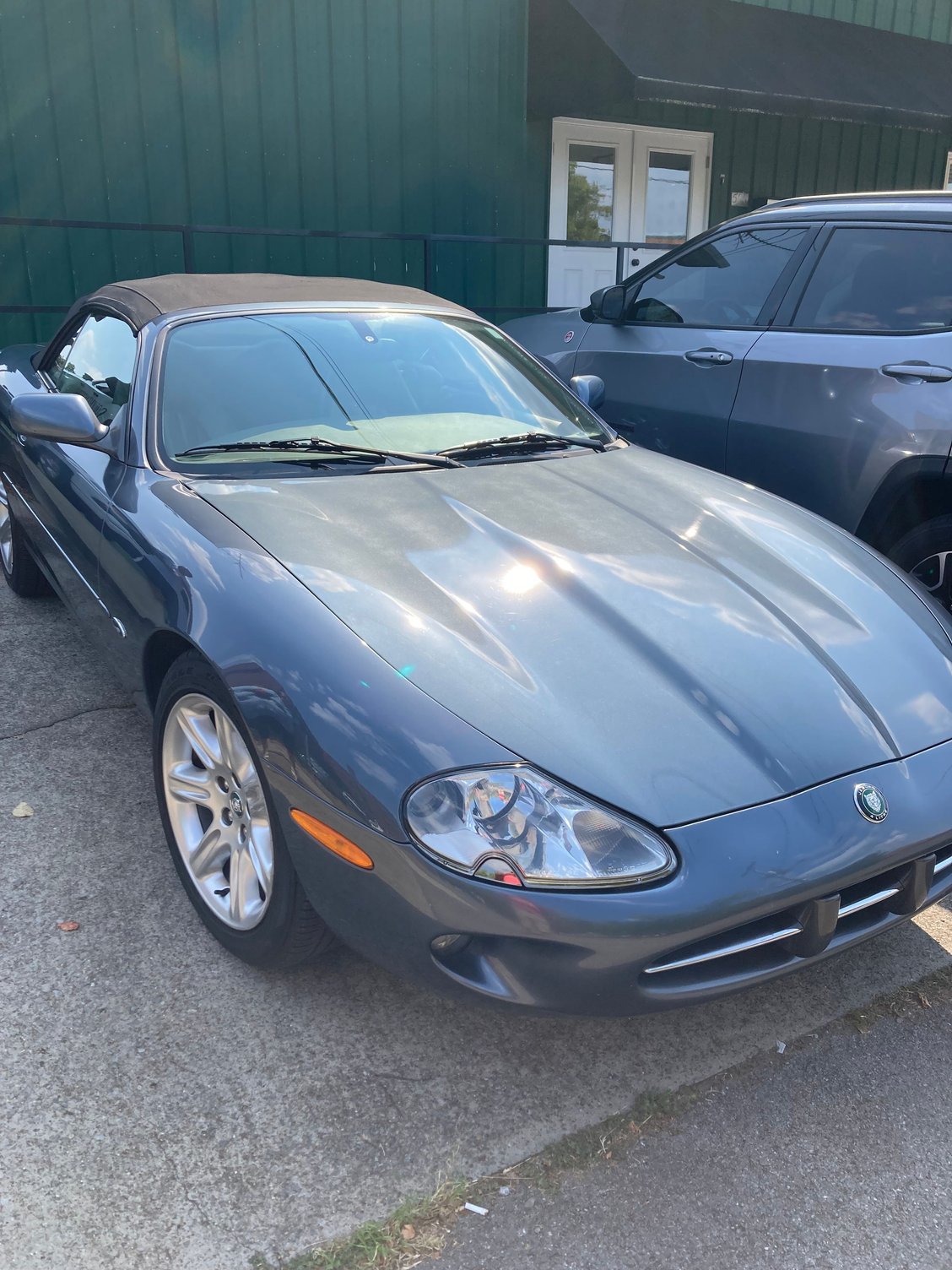

Test drove this 2000 XK8. Very nice car, 27K actual miles, very clean, has a number of exterior finish blemishes. Looked for the engine number and did not find it where I've read it is supposed to be. Asking price is $12K. Everything works, new top, new battery, new fuel pump and cleaned tank, new tires. Very quiet on start up and tight rattle free drive. Comments??
Old Sep 27, 2023 | 03:18 PM
Posts: 25,844
Likes: 4,707
pay an indie to have a pre-purchase inspection done. did you notice any flaking of the front upper shock mounts - originals are foam and disintegrate into powder - even with low mileage, at 23 yrs, I would expect them to be failing and in need of replacement (DIY is about $500; mechanic about $1500 - 2000). At 23 years and only 27K on the clock I would expect hoses/seals/rubber bits to be dry rotting from non-use. Would I still consider it - hell yeah but maybe offer 10K depending on pre-purchase inspection. Any pics?

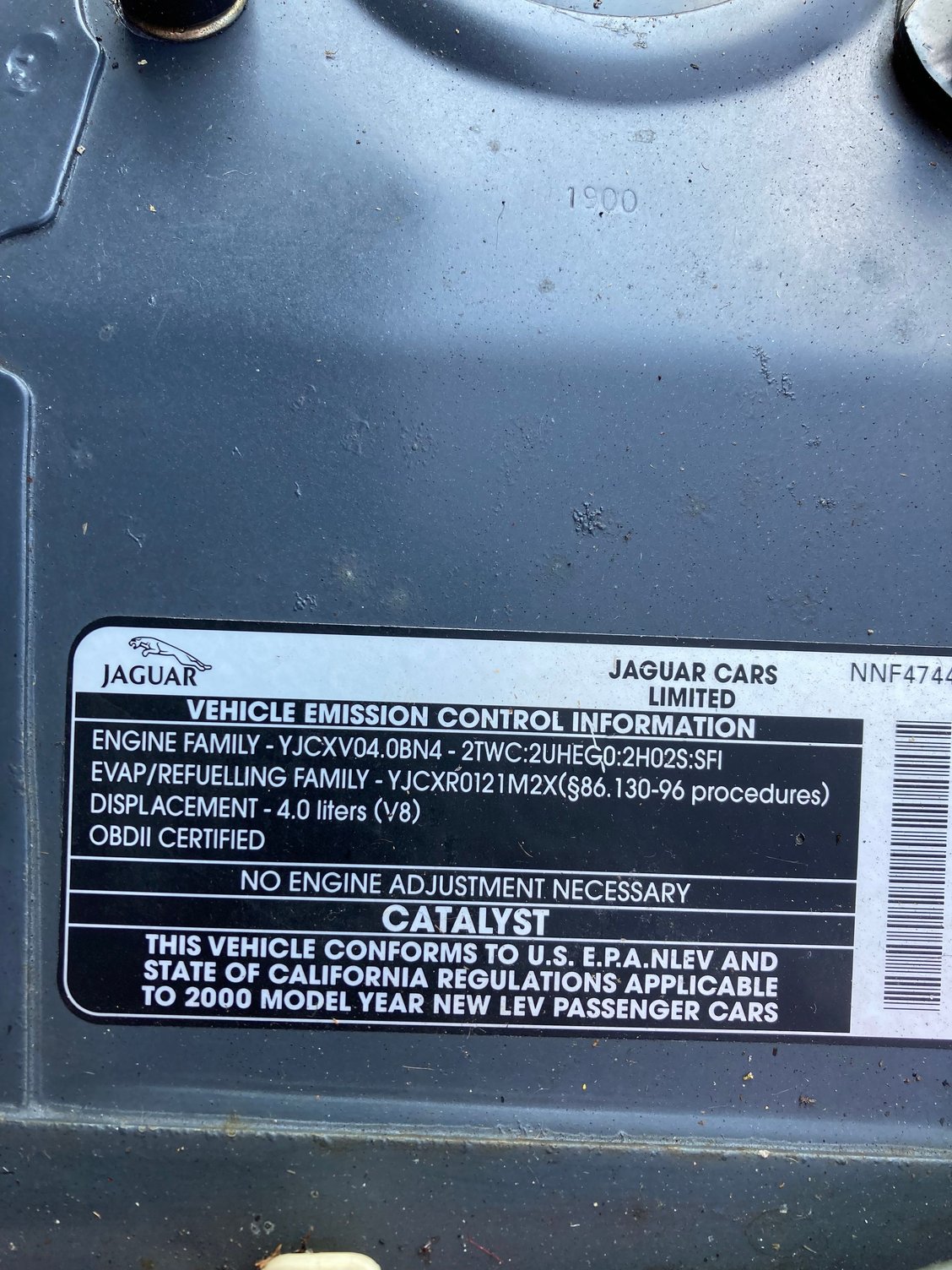

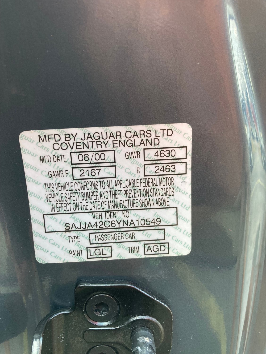

Since I could not find the engine number, can anything be determined from the pictured tag concerning the engine build date?
Old Sep 27, 2023 | 05:46 PM
Jag#4's Avatar
Joined: Feb 2012
Posts: 2,997
Likes: 714
From: Waco, Texas, US
I wouldn't worry about the Nikasil engine. The problem originally was with the type of gasoline available. That isn't sold anymore so you should be fine. I have a 1997 with 97k miles and no worries.
