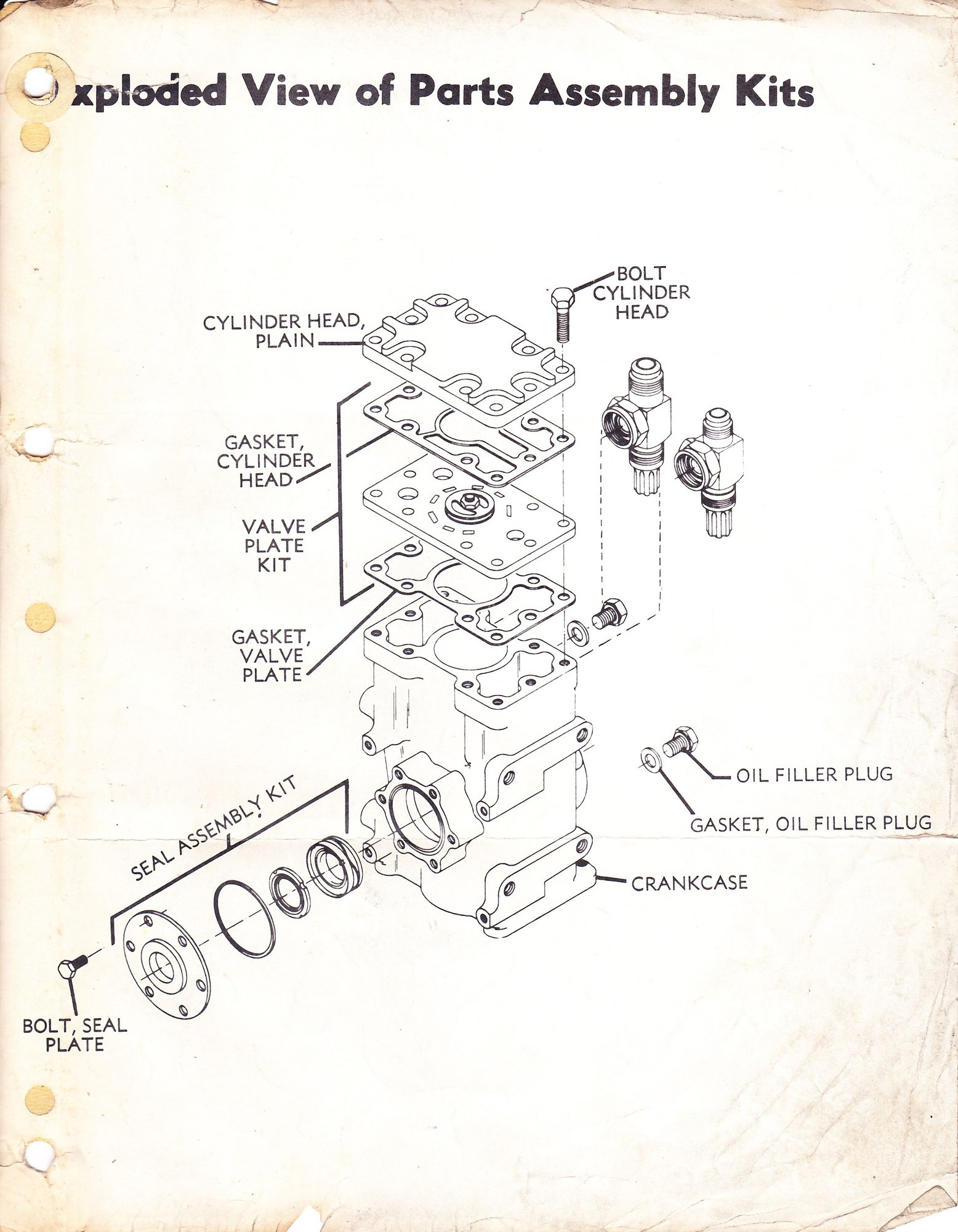

The E type used a special clutch which mounted with internal bolts (3 of the 6 that hold the front seal. They did this as the normal external bosses for the coil were machined off for the E type for fit. If your compressor has the 4 holes on the tabs for the clutch it is incorrect and will not fit well in the space. The Tractor parts supply is an excellent starting point.

Just for clarity we pulled this rather rare document from the files.. Note the drilled and tapped holes on the 4 tabs. Real E type HG500s have only a small amount of the tabs left and they were not drilled or taped. The cases were machined at an early point. Also note in the parts list no clutch or flywheel is listed. We are not sure but it is possible the coil and flywheel were sourced elsewhere but we have no data on that.
