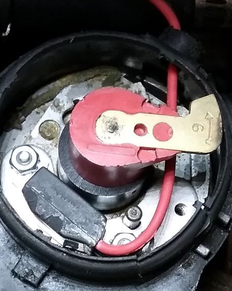

After a couple of years of bad quality control for points/ condenser on my generally reliable E, I opted to give Pertronix a try. My shop assured me that the Pertronix were trouble free and whatever bad I had heard about them was in the past. This was 5 years ago. So true to his promise to not have an automotive breakdown in a bad place. Mr. E conked out on me a mere 4 miles from home and in town, not on some highway. Rudimentary diagnostics: checking for spark, (none at any plug), checking for fuel, yes pump working, makes me think the pertronix died. No apparent damage to inside of cap,, rotor has a little burned spot on the edge of its blade,, and the pertronix module doesn't look fried,, but it does have a curious whitish 'stain' on it, almost like a dried salt stain.. I want to check voltage to the coil tomorrow. Have appt at shop set up. Have read the positive comments on the 123 distributor and am leaning in that direction. Will pair it with the recommended Bosch Red coil. I will have to do up different wires, as the ones I have now are the screw-on to the distributor type. The existing distributor in the car is, I believe, original and so, 52 years old. Anything else I should consider?

OK, good to know all that. At this point I'm just going to do the 'base' version of the Jaguar XK unit. I am probably going to go with the resin-filled Bosch coil. I'm not sure if the Pertronix flamethrower that was installed in 2016 with the module is now compromised as well, so why take the chance? If I go with all the parts that are supposed to play nicely together, IMO it removes some of the 'well, you didn't......" Will post updates. Appt is for 8/17/21. Photo shows inside of current distributor, the module and the curious white 'stain' on it.

All that white build-up and some-what burnt rotor is indicative of a very hot spark flash.
This probably caused the Pertronix unit to burn out _ too much current flow in the primary windings _ not enough resistance of 1.5 ohms or less, and too much current flow through the Pertronix unit.
Check the resistance on the primary windings between the + and - terminals of the coil, making sure there is nothing connected to either side of the terminals when measuring.
The new Pertronix units are supposed to be shielded from very hot spark flash, so that should not be a problem, contacting Pertronix with that photo may also yield some answers.
I did a lot of reading on the 123 Ignition system, I plan on putting it in one of my cars eventually.
The unit is very sensitive to the correct coil, the instructions on their web site must followed.
The spark plug wires must be home all the way with in the boot and on the centre electrode of the coil.
If the spark is forced to jump any other place other then the spark plug, it will burn the unit out.
