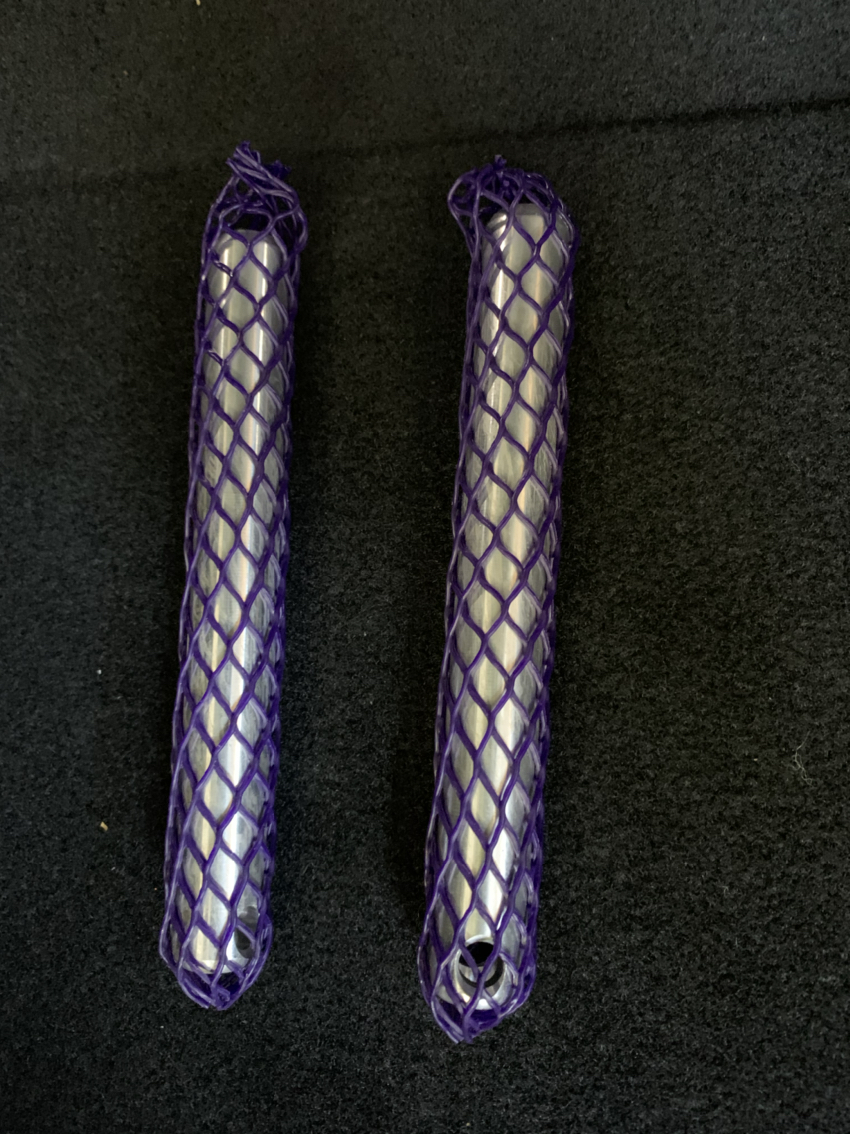

2) Never seen any such pins in my car. Might only be provided with the spare tire option.

According to my copy of the Workshop Manual (which has literally dozens of pages about the CCM brakes although I don't have CCM brakes!) the wheel guide pins are "in the vehicle tool kit". It says this at least 15 times but never once does it show you a pic of this elusive tool kit or where it is!
On my car the "vehicle tool kit" such as it is is made up of bits and pieces stuck in the polyurethane insert which sits in the inside rim of the space saver spare.
For those without a space saver I think the "tool kit" is under the cover in the hatch, next to the battery, again stuck in various slots and holes in polyurethane.
Of course the SVR may be completely different and who knows where the tool kit hides on one of them!
If you can't find your guide pins there are plenty of generic ones with the correct thread on Fleabay.

They are "needed" only for those cars with CCM brakes so as to help prevent damage to the (massively expensive) rotor when removing or replacing a wheel, so in theory they are included in the tool kit only on cars with CCM brakes.

- the 'guide pins' for the carbon matrix wheels are in that polystyrene insert under the trunk floor. Photo below
