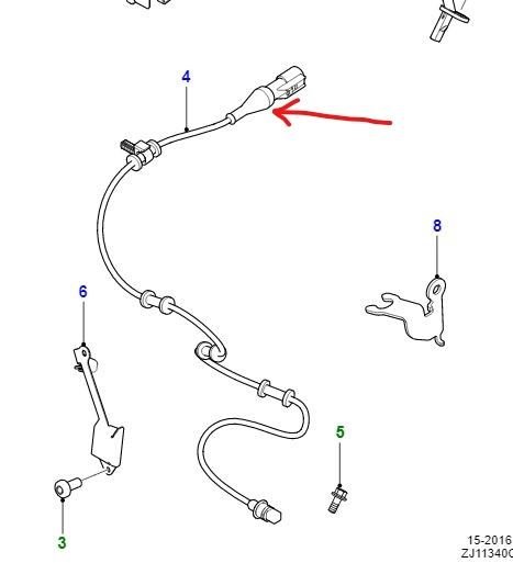

Took delivery of my dream (and first) car a few days ago. During some semi-spirited driving last night, my dash lit up with several messages: Emergency brake assist not available, Adaptive dynamics fault, ABS fault, Parking brake fault, Stability control not available drive with care, E-Diff not available.
Gave it a wash today and noticed a wire hanging behind the front right wheel. Pictures are attached.
My local service shop won’t be able to see me for another two weeks, so I’m wondering if anyone knows if this is something I can easily get fixed myself.
Thanks!

OH MY;;; Could it be the brake pad sensor ?

Nup, no chance, that is always on the LHS not the RHS. For the front that is, opposite on the rear.
Looks more like an ABS wire to me.

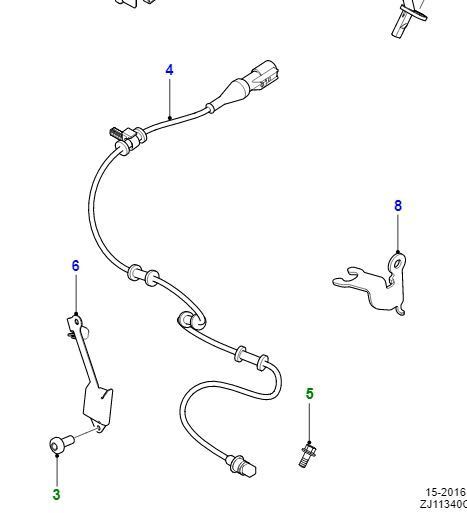

As you say Looks like the Wheel speed sensor Wheel speed sensor

Originally Posted by Unhingd
The hanging wire is far more suspect. I’m betting that reconnecting the wheel speed sensor will resolve the warning messages.
I would suggest from the photo it been damaged and will need replacing, you can see the white and black internal cores
You are correct. The connector is missing.

RayJag1 did you manage to get the wheel off and have look ? Part numbers are in my first post. Cost are uk pounds + tax.just gives you an idea of cost.

Had a look at the speed sensor cable on my car as I had the front wheels off and looking how low the cable is hanging down in the photo, also the rubber gland on the end of the cable, it must have been ripped out of the plug behind the wheel liner.
Hope you get it sorted.
