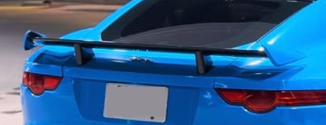

Hi friends! So I have a lead on a car - it's not my ideal, but there are some nice things about it. It's amazing what you miss when you're out of the country. I've had a lead on 4 perfect cars since July, including 3 S in fantastic shape and an RWD R. I've also found a red R with carbon roof, but the owner isn't responding. I guess that's life.
Anyway, this one that I'm currently looking at, the owner had installed an aftermarket wing, for which he had to disable to spoiler from coming up at speed. When I asked if he knew how much of a pain it would be to reactivate it, he said "For the wing to be activated again you would probably have to order the certain part that I cut to disable it because it was the only way to actually make that happen."
Would anyone have some idea of what part he's talking about, and if so, roughly what kind of cost/work it would take to repair? I'm assuming I'd also need to get a new spoiler panel itself since he has likely drilled holes in the existing one to mount this wing. On the other hand, could this be something that screams 'walk away!' the rest of the car (at least from a distance) seems in great shape, and he's fine w/ me taking it for a PPI.
Thanks!
Below: the spoiler in question

The part the owner is talking about that he cut is the panel that has the motor attached to it (underneath the spoiler itself). He cut the rod from the motor. You would need to buy that panel with motor and rod. When I installed my fixed wing, I bought a second one of those so I could always revert back to stock.

Aha, I was looking at some of these panels on ebay when I was costing out a fix. With and without the underneath mechanism.

That wing is not staying on... one of the things I love about the F-Type is all the little transformery bits - like the spoiler. I'm an 8 year old boy sometimes, what can I say.
