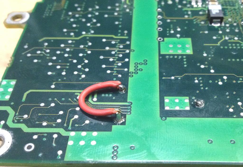

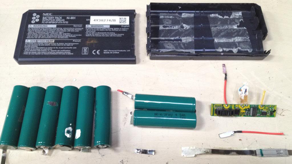

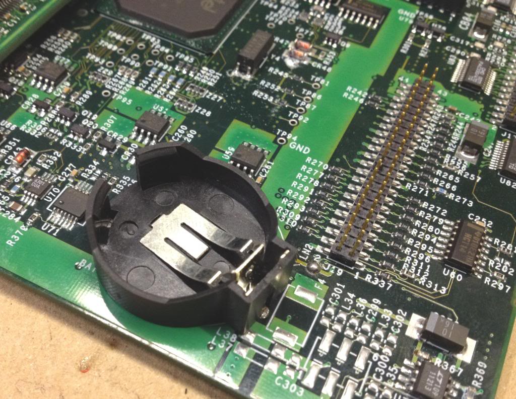

Well I have replaced the 3V battery on the main board which now shows 3.15V.
I have built up a replacement main battery that now reads 9.9V when fully charged.
Put it all back together.
Pressed the green on button & all get is the first green LED light up to say it's on, the fourth green LED to say an external power source is connected (dock station) & a flashing fifth red LED.
It beeps when you press the green button & that's it, nothing else happens.
Infact I can't get the power on LED to go off & have to disconnect the battery.
Anybody got any idea's?

3V battery is a custom jobbie so to replace it get a new CR2450 & a holder like below.
It fits into two of the holes but you need to bridge to the 3rd.
& if you want to replace old main batteries with more powerful top branded ones on the cheap look for the correct 9.6V 4500mah laptop battery on eBay etc.
This one cost me 8 pounds total & was perfect.

Nice try...
unfortunately the symptoms make me think you have a busted unit... especially if you found water in it...
i.e. I can see some dirt around those smd diodes near the battery in the first picture...
I would try to clean the board thoroughly with a toothbrush and some thinner (alcohol or gasoline).
Then you can search for shorted regulators, diodes etc with a multimeter... but if the water has reached the underneath of the cpu, chipset, memmory chips... you will probably need "re-balling" with is rather expensive and may not work...
You can put the unit back in the docking station and use something like that to see what chip seems to have the problem...
http://www.ebay.co.uk/itm/LCD-PCI-PC...item4604fe048c
