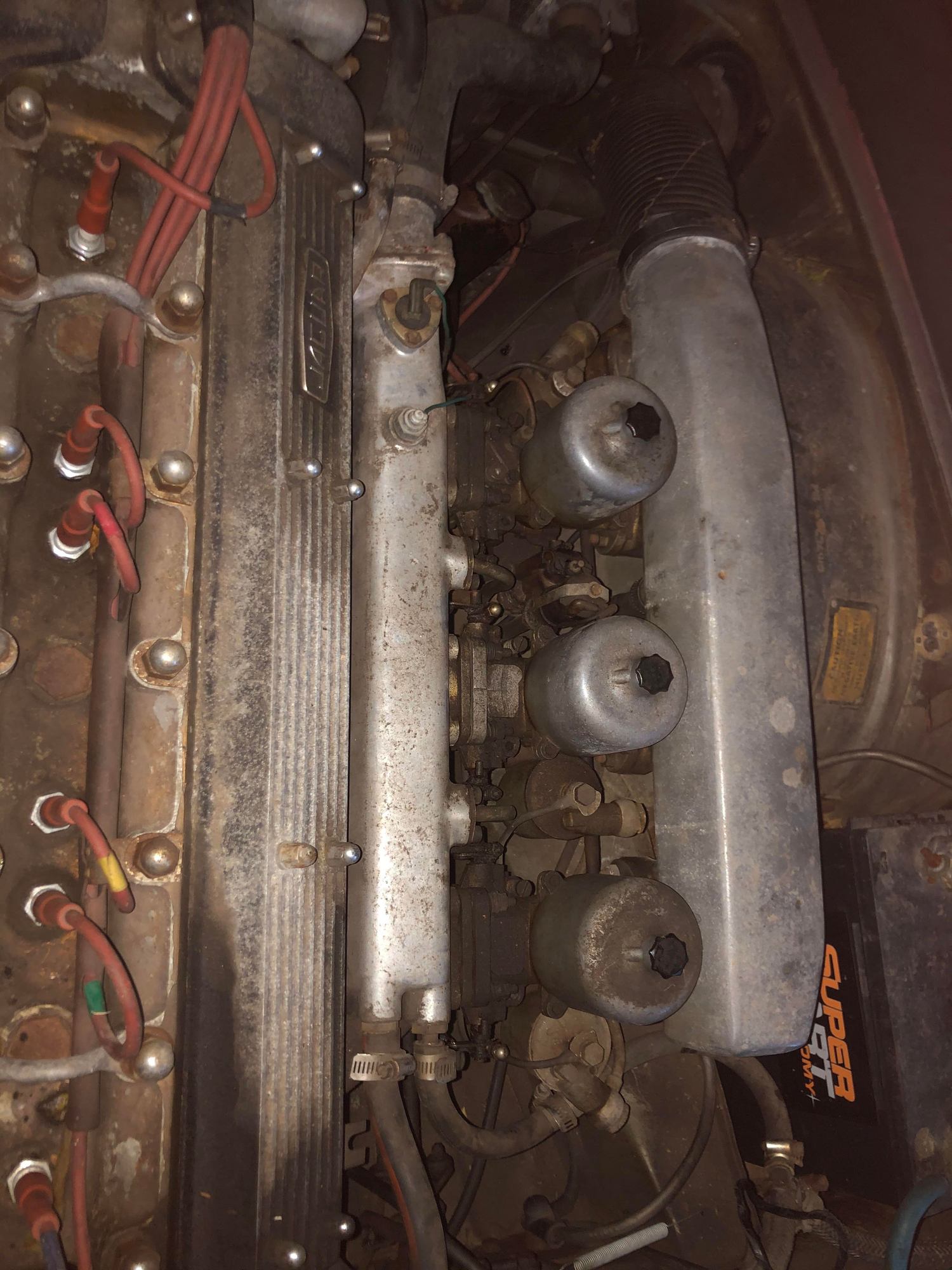

Old Jul 24, 2020 | 04:23 PM
Fraser Mitchell's Avatar
Posts: 9,547
Likes: 2,546
From: Crewe, England
As your car is a US version, can you say what carburettors you have. I would expect there to be an automatic enrichment device, but US cars may be different. A photo might help.
Old Jul 24, 2020 | 09:13 PM
bear747's Avatar
Joined: Jul 2020
Posts: 8
From: oakville
Hi
Please see attached
Old Jul 25, 2020 | 05:00 AM
Posts: 9,547
Likes: 2,546
If you look between the top and middle carbs you'll see the AED device with its aluminium-coloured strap with a lttle securing screw at the top. That device is switched electrically. You might care to consider removing the whole of the induction side and to dismantle the carbs and rebuild with a rebuild kit.

Old Jun 11, 2021 | 03:31 PM
thorswhisper's Avatar
Joined: Jun 2021
Posts: 32
From: Louisiana
Vacuum Leak. Check manifold gaskets, especially to carb bodies.
