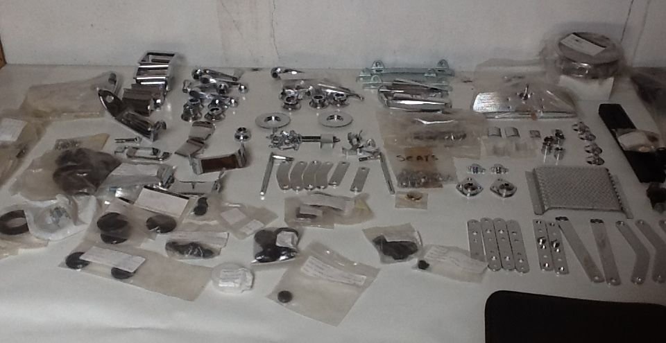

I rechromed my handle, knob & cover plate. I don't recall how we separated the knob ~ we rechromed everything or replaced with NOS. I don't have a pic of the new biscuit interior that shows the handbrake lever.
Some of the rest
