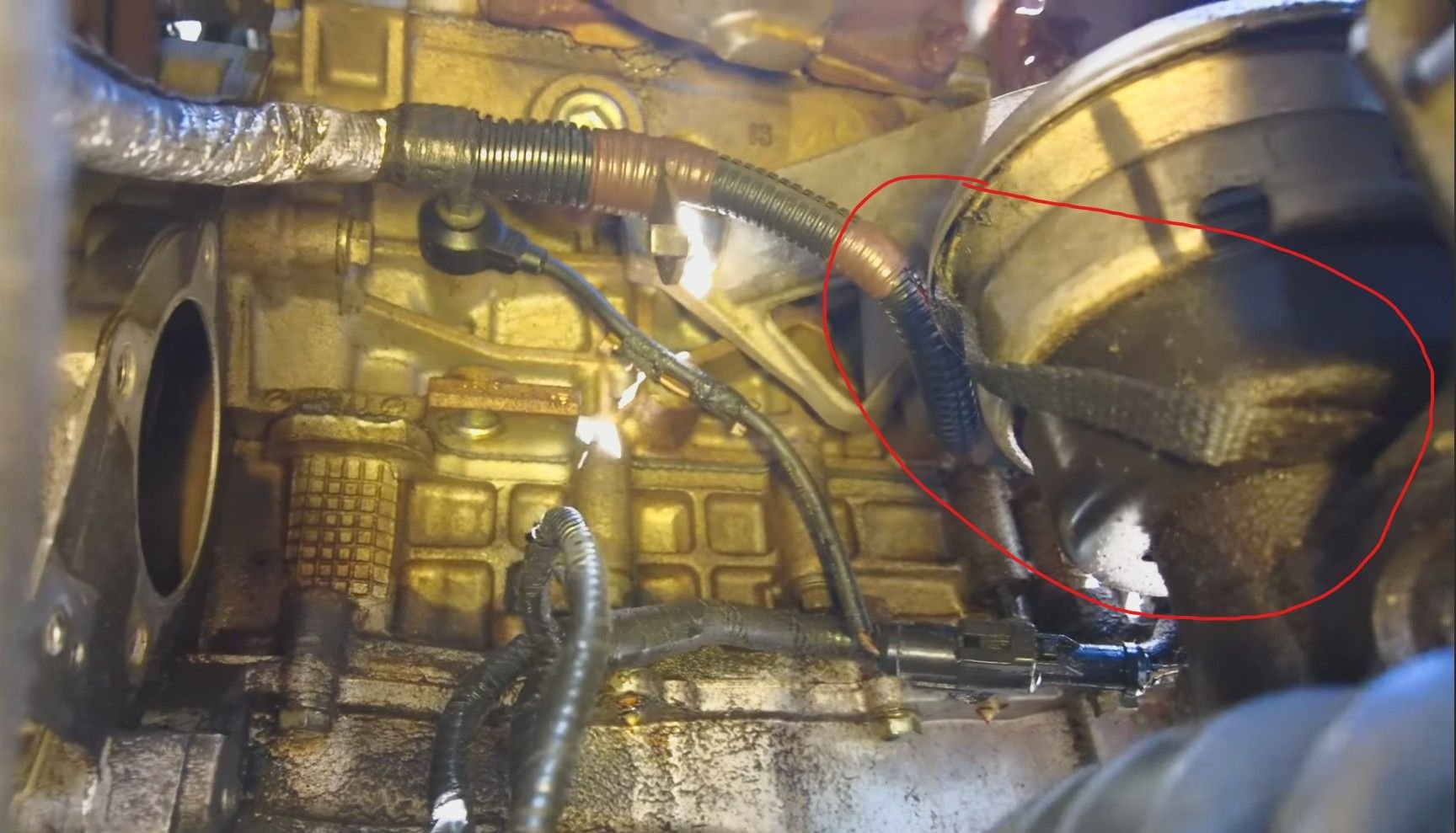

In trying to respond I deleted your photo. I think that instead of clicking Quote, I clicked Edit, and proceeded to type assuming I was creating a new post that quoted yours. Instead, I was editing your post, and the first thing I did was to delete the photo so it wouldn't take up space in the quotation in my post! Obvioiusly, I'm dangerous with moderator tools at my disposal.
Your photo shows the safety strap for the hydraulic engine mount, which is not an electrical conductor. I believe it just prevents catstrophic separation of the mount.
Please post the photo again if you get a chance. I'm very sorry I messed up!

Hmm, been doing some mental aerobics, trying to deduce what would happen if the engine’s ground cable was indeed missing.
I've seen this on other vehicles. The typical symptom is the starter cranking speed is slow. With the proper ground path interrupted, current will find some other route to ground, such as via the transmission and driveshaft, metal fuel lines, etc.
But Jon did say the starter cranked okay when the relay was jumpered. That suggests the ground path is adequate, even if not perfect.
For some quick troubleshooting, you could attach a temporary ground cable. One side of jumper cables would be perfect. No need to crawl underneath. Connect one clamp to a convenient bare spot on the engine. Connect the other end to a good ground on the chassis. See what happens.
