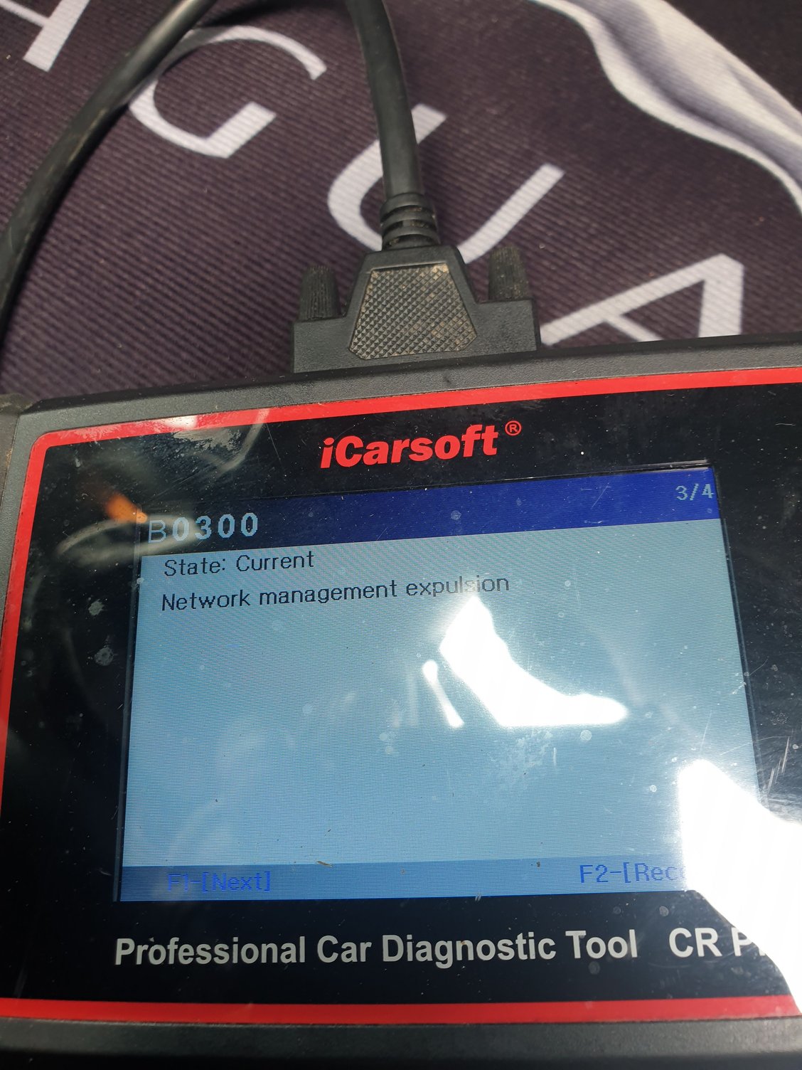

hi after a six month rebuild on my 4.2 v8
and getting a new code B0300 network management expulsion that has been doing my head in
took car to jaguar dealership today
Some have said it was my scanner
Well dam jaguar nz got the exact same code as i did
BO300

For what you describe, should be a P code. Also, there's no B0300.
The tool is almost certainly wrong. I'd use a better one e.g. IDS/SDD.

Even WDS sometimes gets the DTC prefix wrong. (usually at the bottom of the list stating NO DEFINITION)
Just go with P0300 and solve the problem.

when I took my car to jaguar new Zealand yesterday B0300 NETWORK MANAGEMENT EXPULSION was the only fault they brought up as well

Took car for its first run checked for fault codes before leaving no codes car went great no issues at all got home checked for codes had B0300
Cleared codes another run no issues no Restricted performance light fault B0300 back a gain

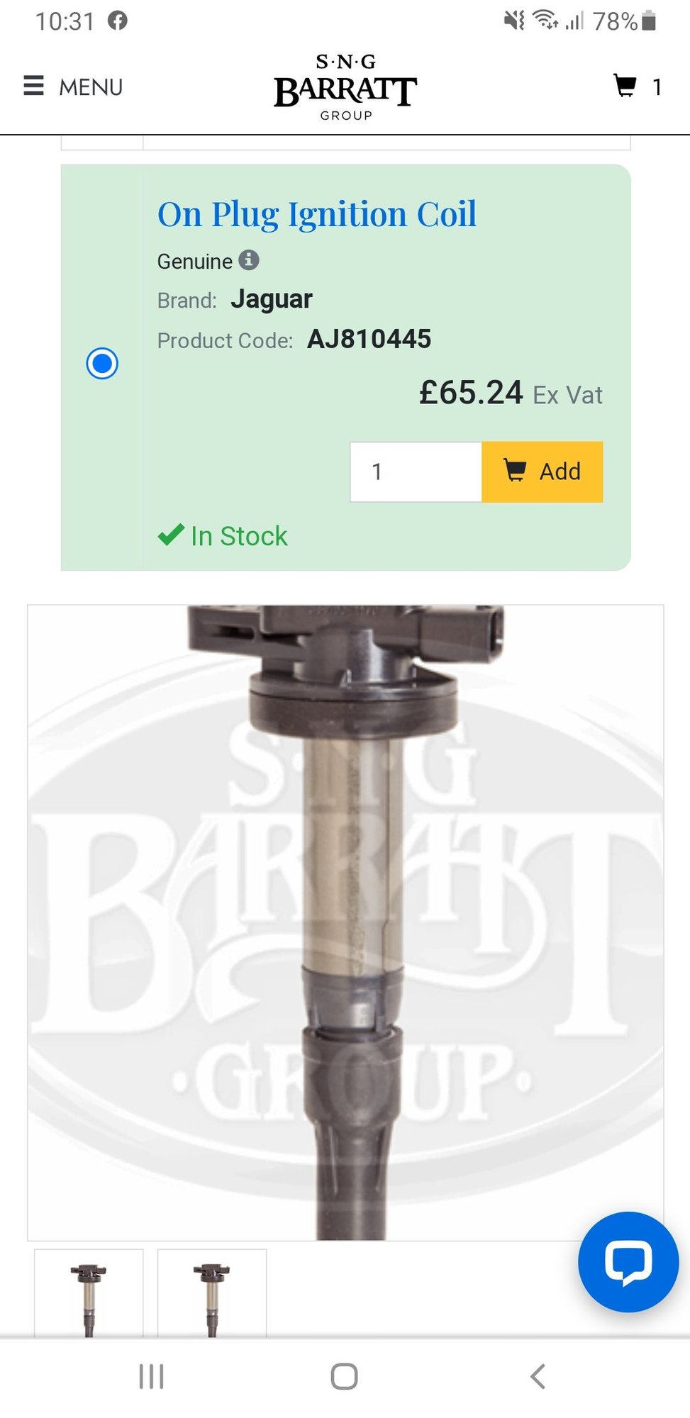

I purchased 8 coils part number AJ810445
I purchased these from sng Barratt in the uk
brand Denso /jaguar
These were what barratts recommended
these cost me with exchange rate $170.00 nzd each plus shipping
so all up coils cost me $1560.00 new Zealand dollars
