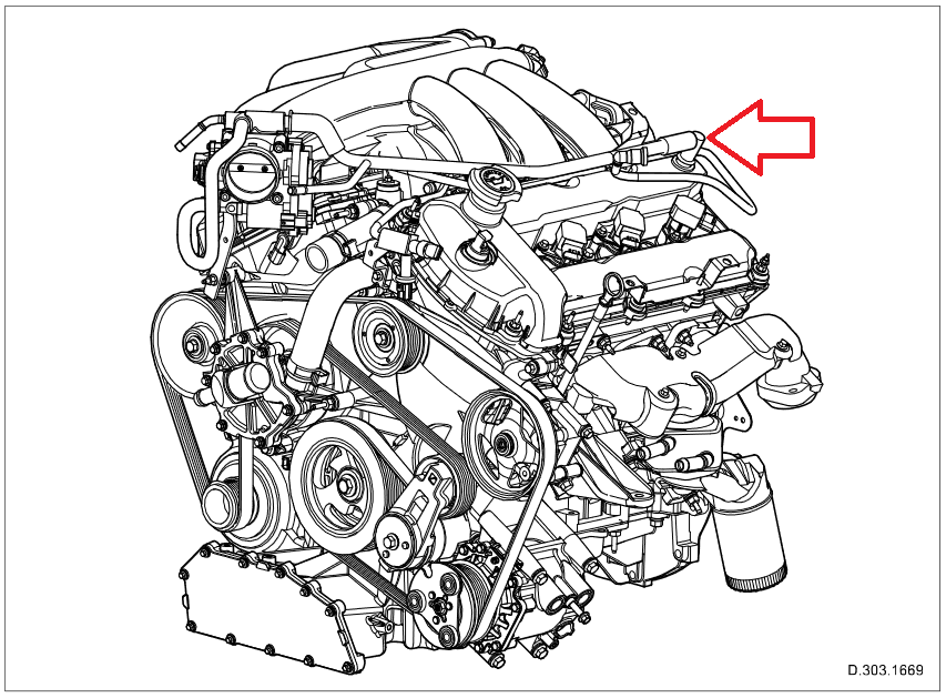

Originally Posted by captron1
Is there a PCV valve in this vehicle?
Yes. I've added an arrow to this image from the training guide to show the location:

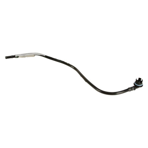

Is item #3 here?:
https://parts.jaguarlandroverclassic.../brand/jaguar/
If so, that is Jaguar part number XR848129. Take a look at this link:
https://www.carid.com/genuine/pcv-va...-xr848129.html
Note the 4 prongs and the light blue O-ring:
If that is the hose in question, it appears to snap in place. If the prongs are still good, you could probably source a replacement O-ring locally. Any good hardware store should have something of the same dimensions. Make sure it's rated for oil and appropriate temperature. It doesn't have to be the same light blue material.

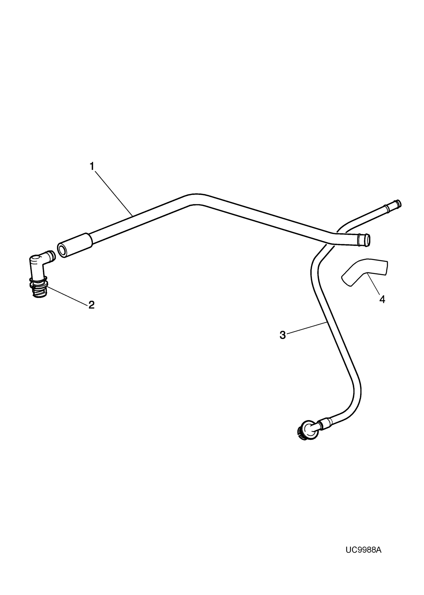

Thank you very much for chiming in....So, I have ordered the PCV valve (in the drawing item #4) and I'll change that out easy enough I think. Yes....item #3 in the drawing is the breather tube with the "loose" valve cover fitting. It's not a lot but I can move it pretty easily and I'm tempted to change that out, but unsure of removal. I see the three prongs on your new part pic, which makes me wonder if they break off inside the valve cover if pry out???
As for the discussion on the hole in air intake hose, I actually started that one and pic in #36 is my air intake hose. I sealed it with fiberglass and codes at that time went away.
Actually i typed too fast. It's valve pictured as #2 that I plan on replacing, which I believe is the PCV valve.

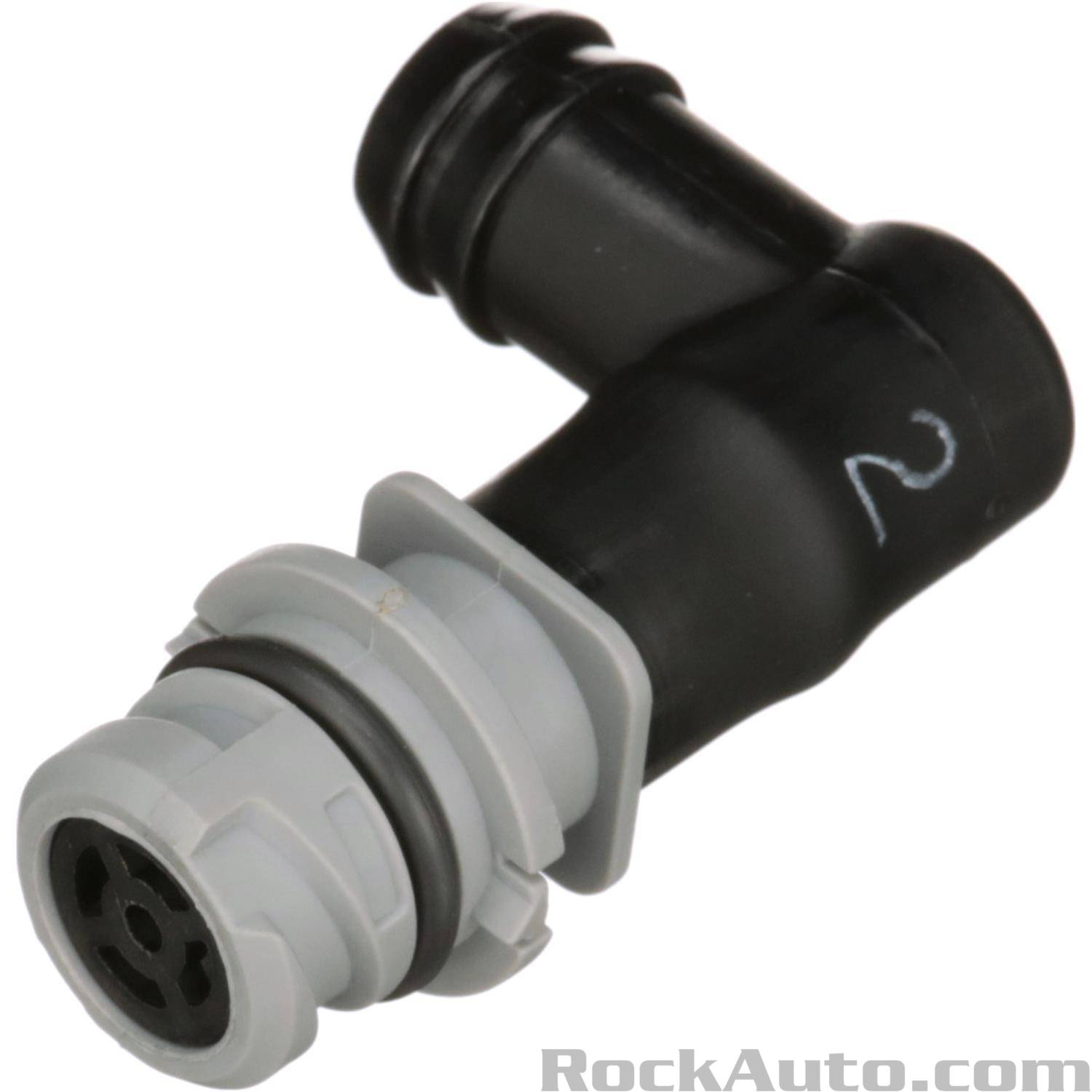

A-ha! The PCV valve has an O-ring, too. Check out this image from RockAuto:
When installed, the O-ring should make a good seal with no play. To remove the valve, turn it a half turn counterclockwise.
