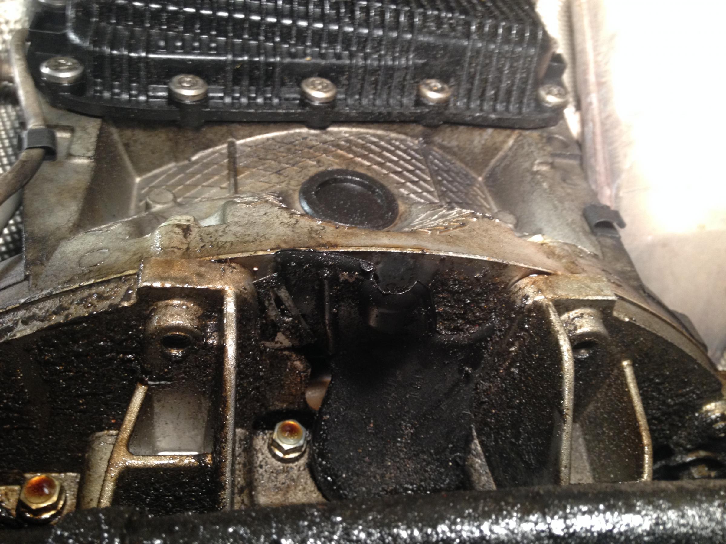

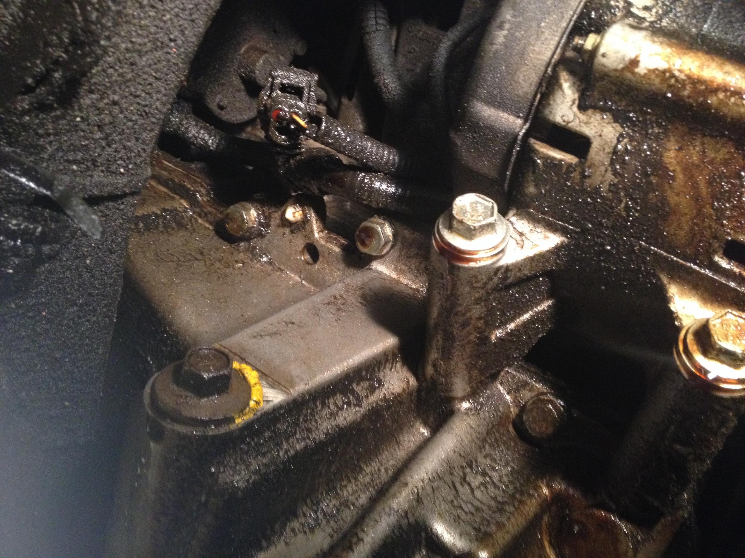

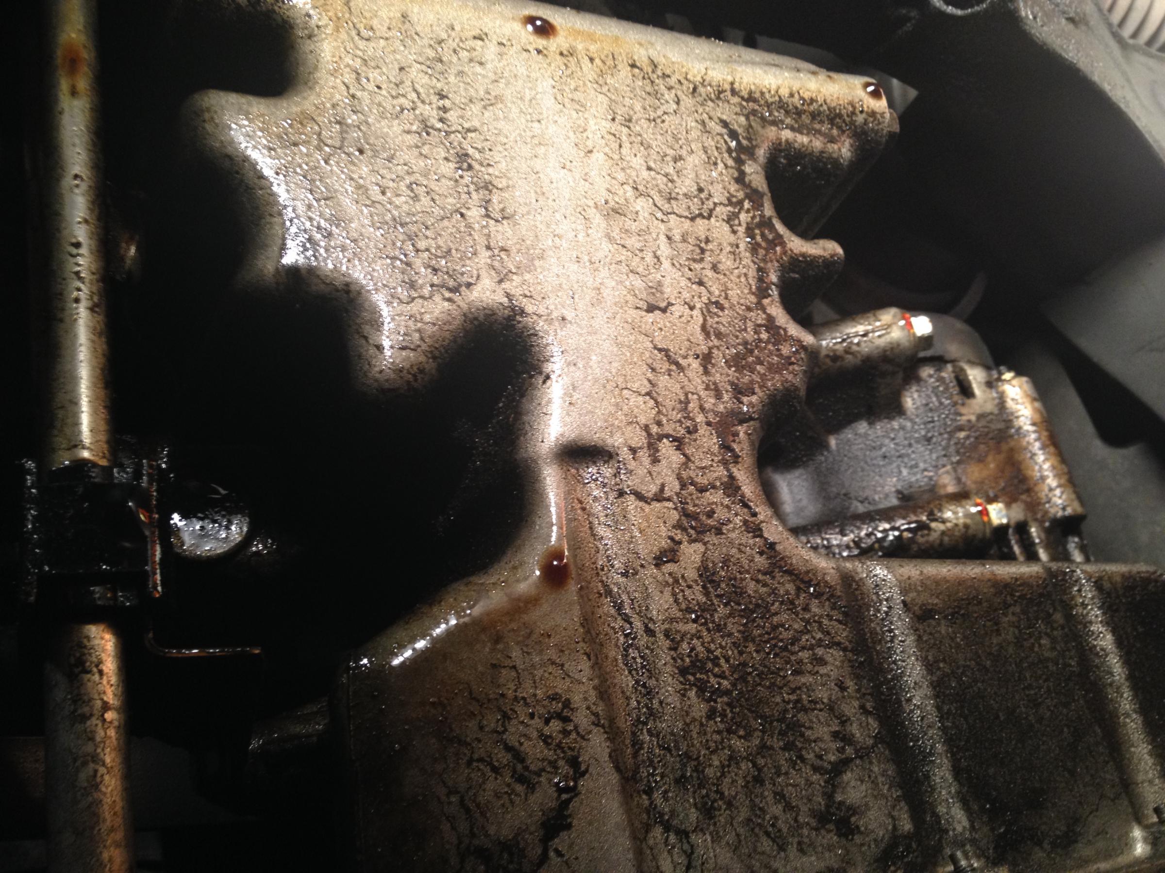

OK, now that I've had a look underneath - pictures attached - a few things come to mind.
When I did the drain/refill/new pan/new bolt procedure back in December, I also bought a new mechatronic sleeve, and did not install it for reasons I cannot now recall. The pictures indicate to me (and also one that was too fuzzy of the mechatronic plug) that perhaps it is leaking in addition to the oil pan leak, and the remains of the power steering line incident.
Which brings me to ask the question... Is it normal to have a hose, about 18" long, that ends in a cap, that when that cap oh, say, gets abraded or torn off on the road, results in a complete voiding of the power steering reservoir? It was just -there-, tucked up into the frame, and I'd noticed it before, but about 30,000 miles ago, I was driving and pulled off into a gas station to fuel up, and realized I had no power steering, and there was a red flood underneath the car, out and up over the roadway where I exited.
An hour later, after a quart of Dexron, a 2" bolt, and some hose clamps, it was refilled and going again, but as I cannot readily tell the difference between the fluids (other than knowing that LG6 smells like rancid cat spray and I never want to be covered in it again) that perhaps:
- The mechatronic sleeve leaks, and has been leaking significantly, or for a very, very long time;
- I may not have filled it completely when I serviced it in December;
- The noise and accompanying RPM gain/loss is due to low fluid
- Bolt torque insufficient causing leakage around the pan lip
I have found pools of tan fluid that smells faintly reminiscent of said rancid cat-spray pocketed up into the bolts and around elsewhere, and especially in the immediate proximity of the now-non-present rubber flap-gasket covering the access to the flywheel in the housing - props to my wonderful partner who tugged and pulled it completely off.
Ideas?
Attached Thumbnails The downshifting squawk noise in the 6HP26-img_0966.jpg   The downshifting squawk noise in the 6HP26-img_0969.jpg   The downshifting squawk noise in the 6HP26-img_0971.jpg   The downshifting squawk noise in the 6HP26-img_0974.jpg   The downshifting squawk noise in the 6HP26-img_0976.jpg
