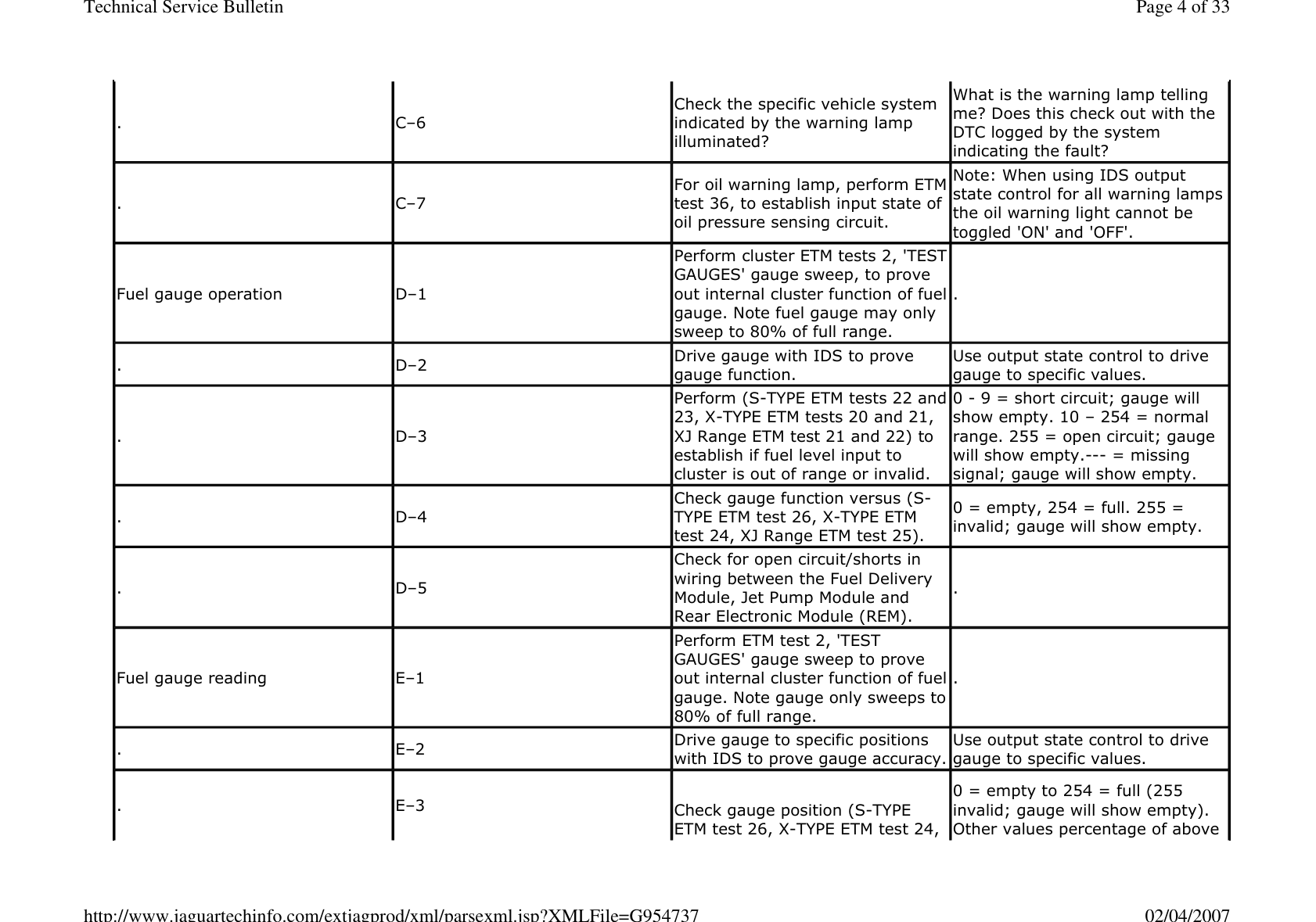

I finally got around to checking the ETM on my fuel gauge issue that I previously posted. I should preface this by saying that the car runs fine. I do not seem to have any issues except that the fuel gauge reads empty at all times. During the ETM, I tested the instrument gauges and the fuel gauge needle seems to be working as it sweeps from empty to full in routine fashion.
The following photos are what I received from the ETM:
Any thoughts on this? I would really appreciate some help. Thanks.

Read up on ETM - later in the values are per side fuel levels.

Motorcarman provided you with a set of technical pdf's from Jaguar, a portion of which I have posted below, While I am sure that you do not possess factory level diagnostics, there are test procedures that can be performed by the layman in Engineering Test Mode. Tests D-3&4 and E-1 come to mind.
As a physician, I am sure you would be hampered by a lack of proper diagnostic equipment, and it is so being the owner of a "modern" Jag. Every jag owner should possess a diagnostic code reader that is capable of reading both OBD-II Diagnostic Trouble Codes and proprietary Jaguar trouble codes. Buy one, you will need it sooner or later if you intend upon sorting your Jag yourself.
