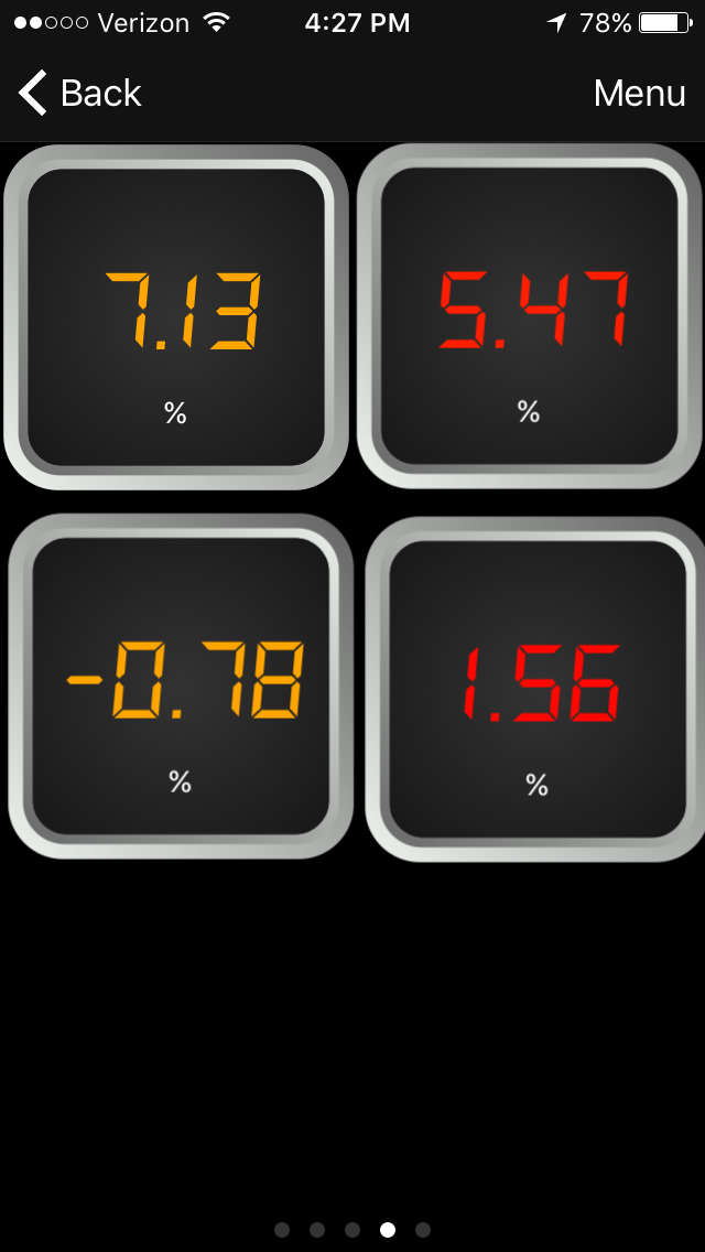

Hopefully those images arent too big, i uploaded them on my phone.
The first one is at idle and the second picture is at 2500 rpm.
Top are both short term and both bottom are long term. Left hand side Bank 1, and both right hand side bank 2.
Ive tried to learn, but im not quite sure how to interpret them.
While monitoring the fuel trims get a can of carb cleaner and start spraying any suspect connections.
I have a 2005 STR and can guarantee the P/B vacuum line is leaking or soon will be.
