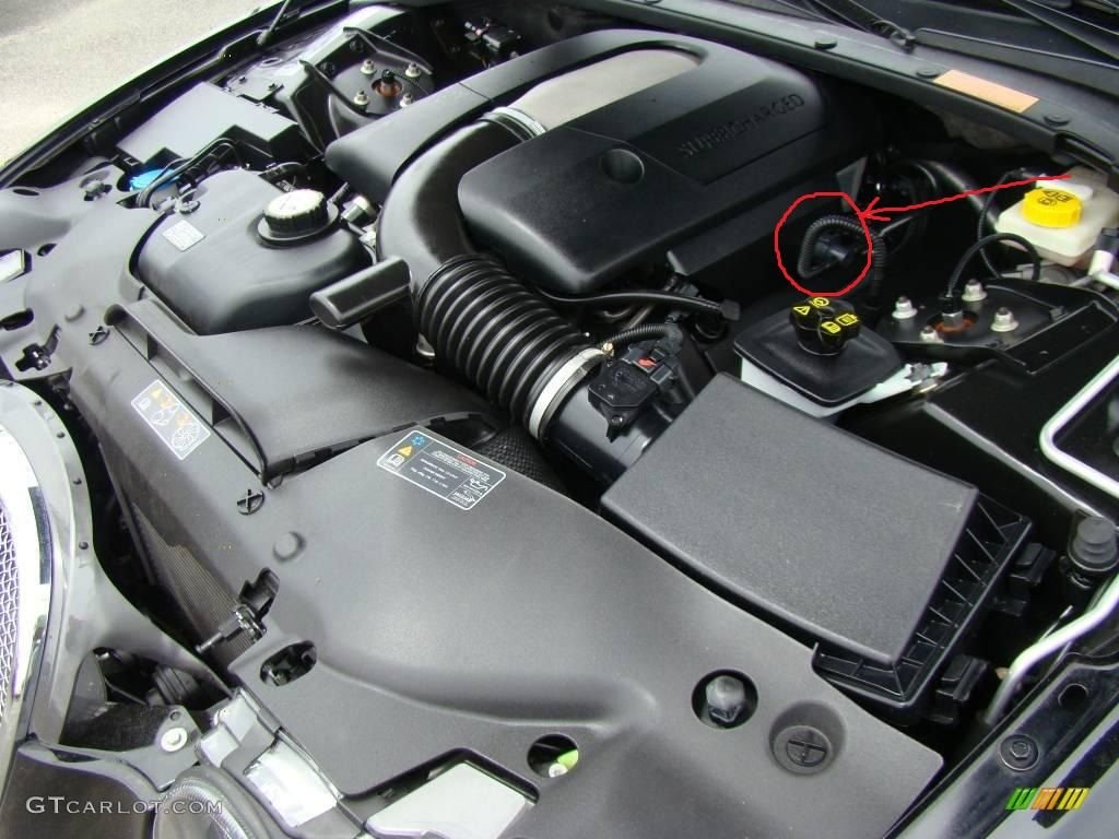

Just realized I never sent out my findings. The purge valve is still under the hood of the 2006 and up. It's just not attached to the canister as in the previous models because of the multiple failures of the canisters mentioned by QuartzSTypeR.
You'll hear it ticking and it's up above the left valve cover. Part# XR849660

Can you say where it's located?

I wrote "purge valve" I meant to say "vacuum valve".

A picture is worth a 1000 words!
That explains it.
Well done.
Boy is your engine clean too.
Had you thought about adding the strut tower covers from the 2003 model?
Cleans up the engine compartment a bit. I added them to my 2005 STR.

The picture is of a 2007 STR, but mine is just as clean :-) My wife laughs at me because I detail the entire car including the engine bay and trunk.
