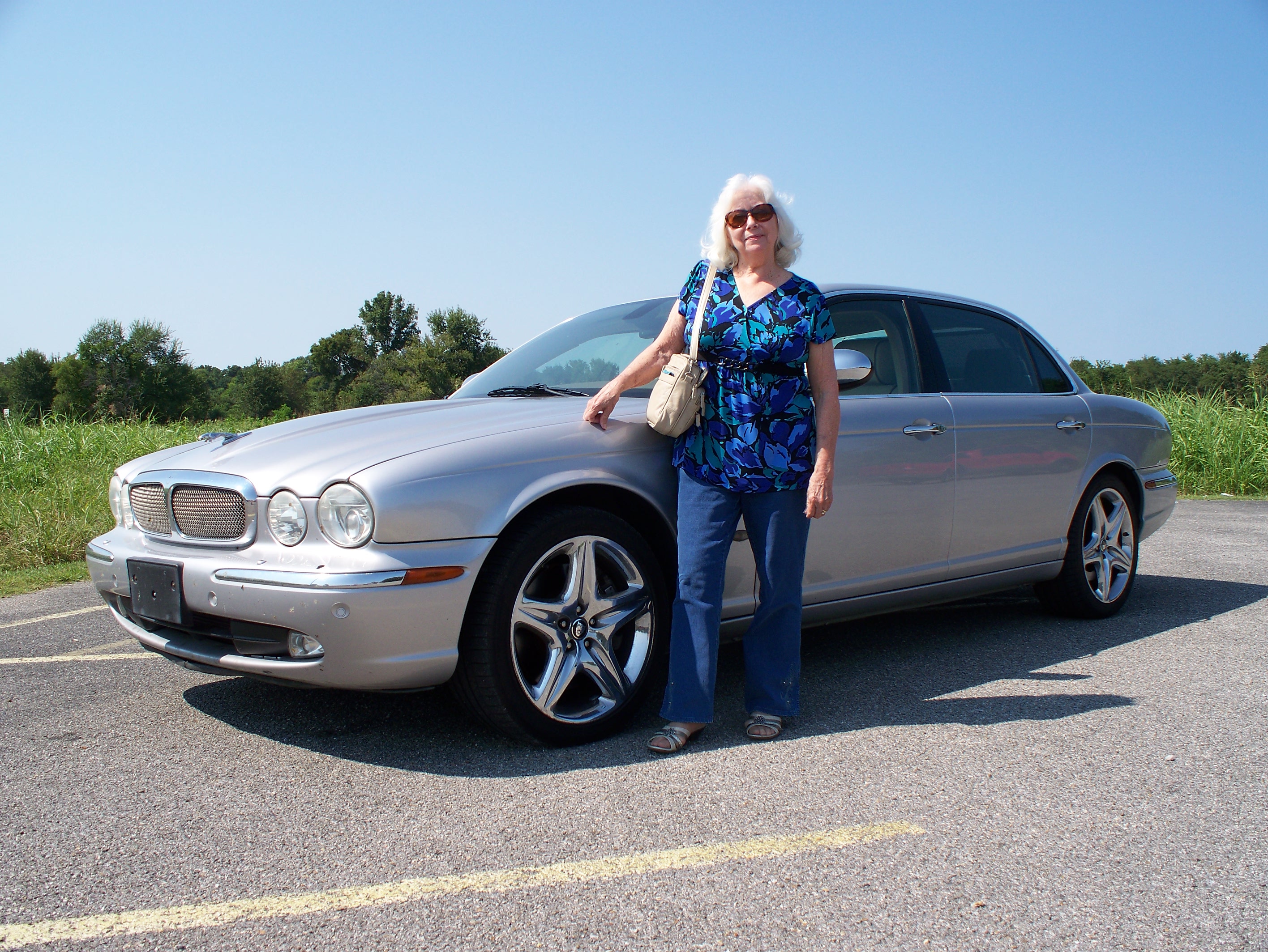

I checked Car-part.com and used T-case prices range from $850 to $1000 before any taxes, shipping, or driving costs. My British car club has a 4-post lift and I have a pretty good collection of tools (if special tools are not required). Still, (assuming that a T-case is all that is needed - Big assumption), I'd be close to the KBB private party fair condition sale price and the KBB good condition PP sale is only $2600. Not a good margin if I wanted to flip it.
But, How is this model as a driver? I already have a well used 06 SV8 for my wife (130 K miles and a few door dings) that is a pleasant car to drive except for a front end clunk. Do X-types have the same bushing problems as the X350s? Any specific things to look for at 130K miles?

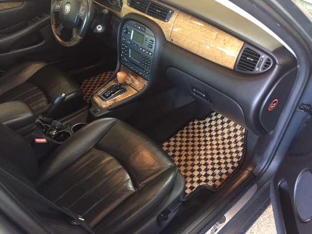

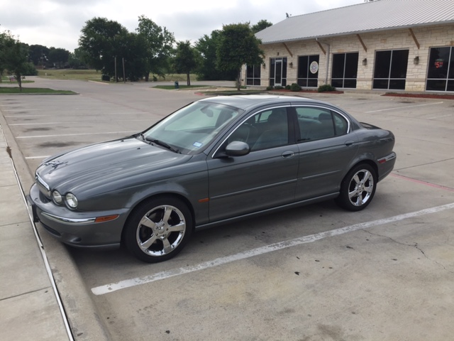

philwarner, thanks for posting the pics. Looks like a nice car - and a definite prospect. Can't speak to the TC job, but will tell you that wife and I really like our X-Type. It's sharp looking inside/out, easy to handle and responsive. Bought ours with 104k miles on it, now at 110k. Took it on a 2k mile road trip in October and it ran flawlessly, gave us 28mpg. Have been working on it steadily to correct some neglected items (fluids, suspension arms, shocks, front brakes, etc.) but everything I've done so far is pretty straightforward. Lack of fluid service is probably what took out the TC on car you're looking at; if you get it do a fluid service on the transmission (not bad) and the differential (not an easy job unfortunately).

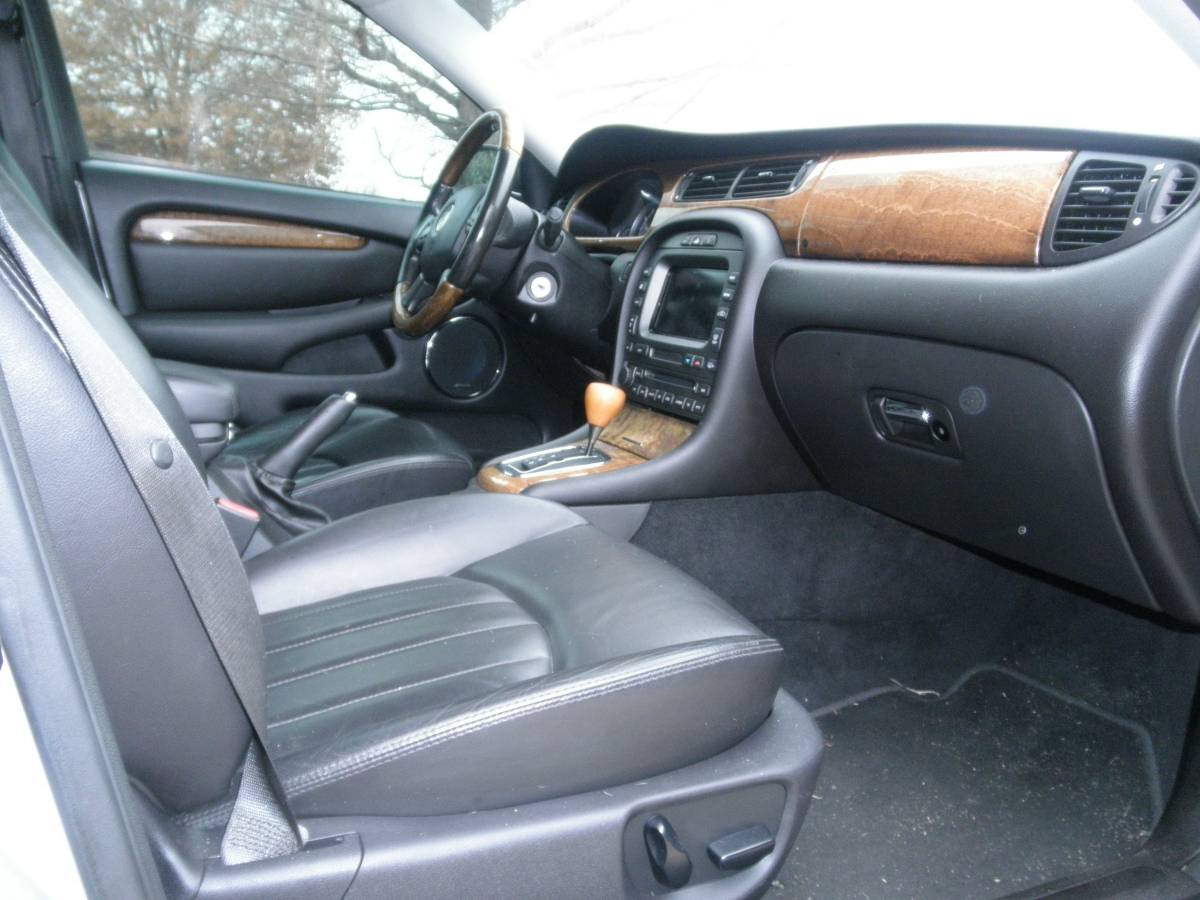

Phil, how was it determined the transfer case was bad? Did you check it yourself, or did the owner say that? Reason I mention that is if it is an incorrect diagnosis maybe it it is something else that could be easy to remedy and you could have a real steal. This looks like the face lift model with the updated, non-viscous coupling transfer case. Those later versions seem to hold up better.
One thing I did see is it does not have DSC. Not the best combination in the snow with the the newer style transfer case

[QUOTE=philwarner;1585649]Did you determine no DSC from the photos or from the VIN?
If you look on the picture of the gear shift look on the bottom right of that area. You'll see an area with some slots in it for holding coins. If the car had DSC there would be an actual button to push with a red LED. I think the button has a pictogram of what looks like a skidding car if I remember correct.
