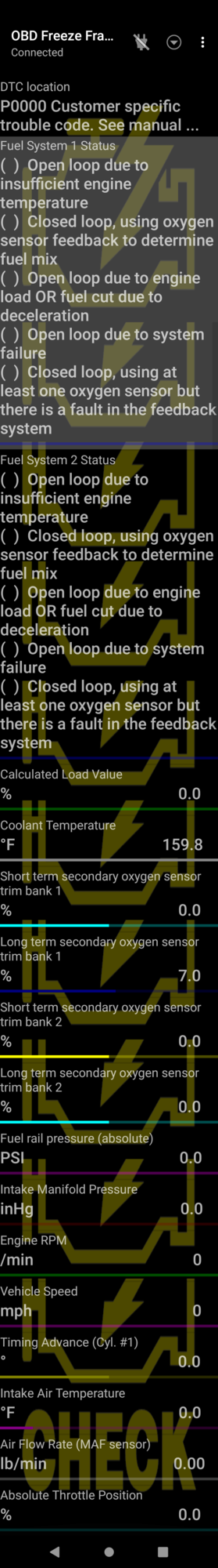

This is what the code reader says. It all started after I changed 1 coil pack, all the spark plugs and the plenum gaskets. There is coolant that has suddenly started getting in the spark plug tubes around the coil sleeves intermitantly. I am at a loss. Any suggestions are welcome. And thank you in advance.
