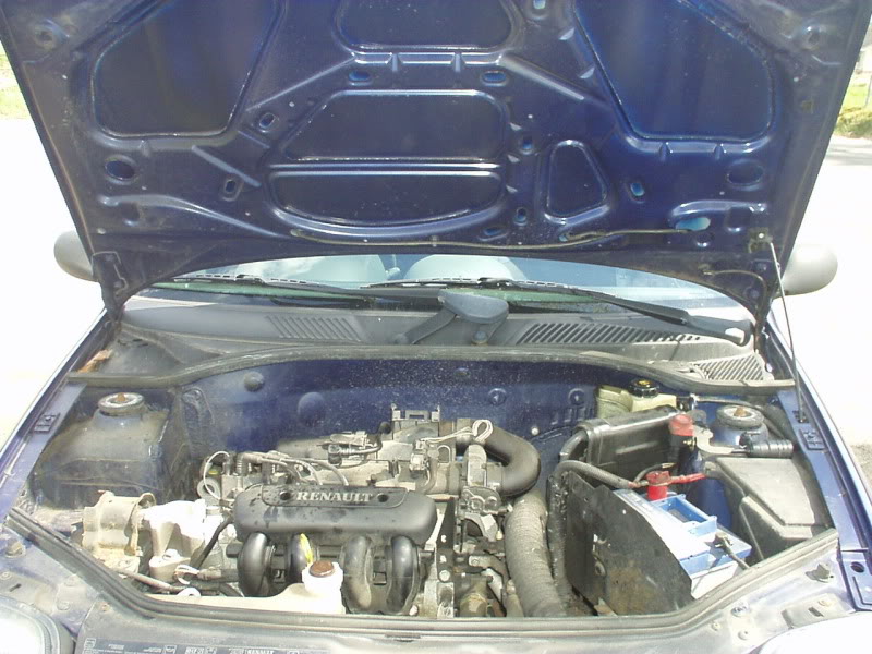

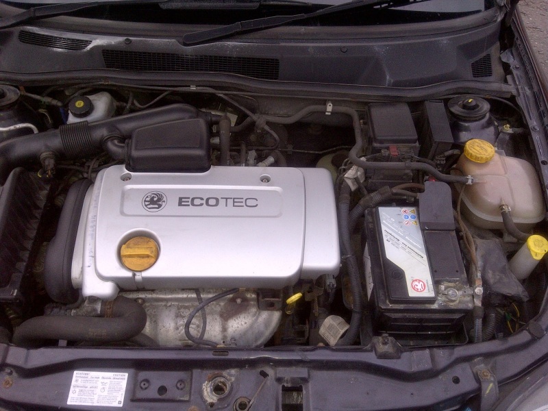

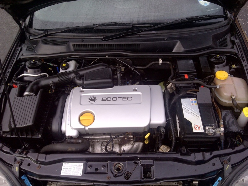

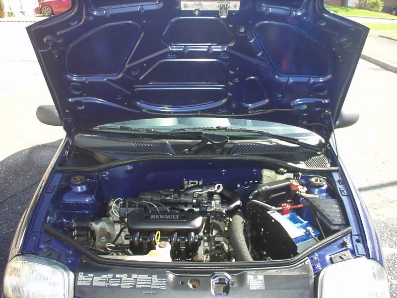

On both my sons older Clios it was a case of a degreaser of sorts followed by agitation with a brush ( Toothbrush for smaller areas - largr version for bigger areas ) and get it cleaned, then a soaking with the garden hose.
The electrical areas were covered by plastic bags and the engine running at the time.
All worked very well with no issues.
My Audi underbonnet is almost as clean as the day it left the factory, its part of my wash routine and only takes a few minutes.
If you're looking to do it on the Jag and its a real mess or never been done before, I'd recomend as follows.......
Get yourself a spray bottle with a hot soapy water mix, a toothbrush or similar, plenty of rags....
Spray the affected areas with the hot soapy water mix and then use the brush to agitate.
Spray the area again and use the rags to dry as necessary.
This should more than suffice to get the area as clean as you want it to be. The rubber / plastic areas can then be treated with back to black or similar to bring back that lustre / sheen to those parts and give a nice clean / shiny engine bay
BEFORE.......
AFTER......
