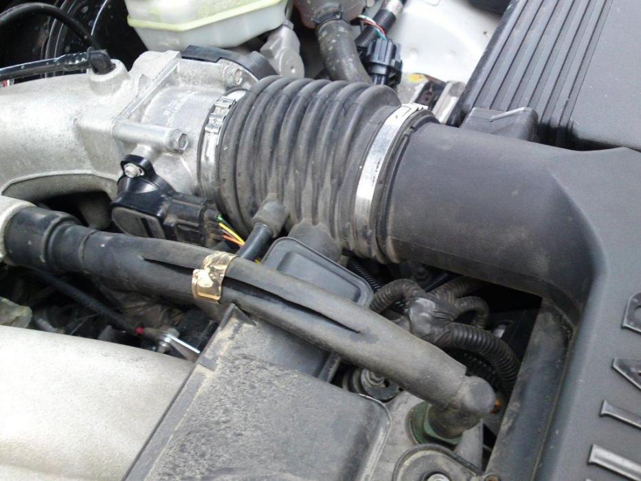

@ bigben your car is experiencing a vacuum leak. that hose probably has a split in it and needs to be changed. this hose is connected to the throttle body that regulates the RPM (Or speed if u want to call it that). This hose will restrict the performance of the vehicle and causing the limp mode or/and cruise not available display to show in the message cluster.Replace the part and your vehicle should return back to normal. let me know if this info. was helpful

An example of a pvc hose with a split. sometimes the split maybe on the underside. hope this help.

Thanks I will check that after I get off work. But I know I have a vacuum leak in the seal around the things bolted in to the left side of the intake manifold, I can hear the air being sucked in there. Whats that part for and whats it called?
