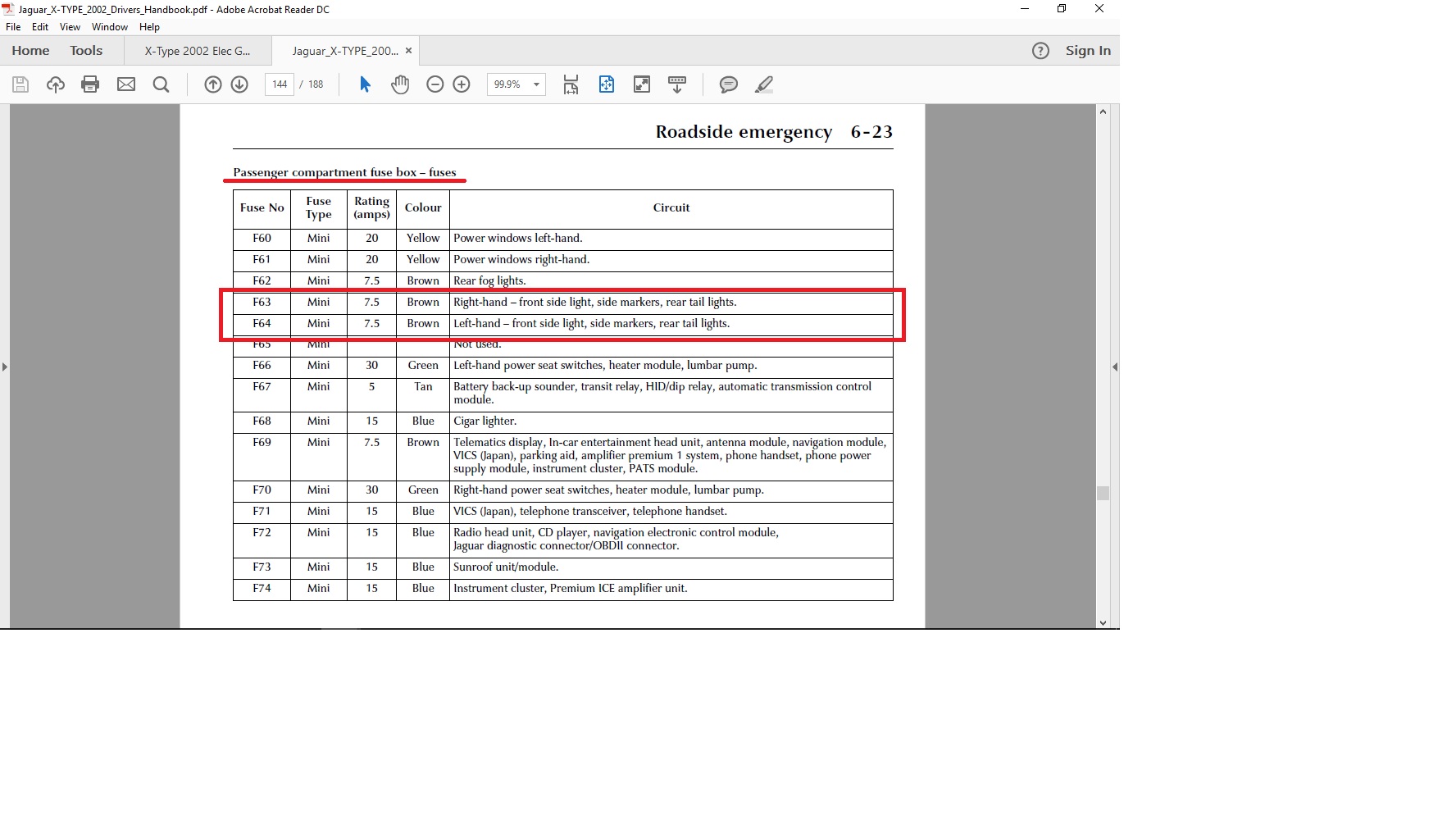

I am guessing that your are talking about the front/side/rear parking lights.
Passenger Compartment Fuse Box - (Driver's side dash)
F63 - 7.5 amp mini (Brown) - Right side
F64 - 7.5 amp mini (Brown) - Left side
See attached below for fuses. - Click once to open and click again to zoom in

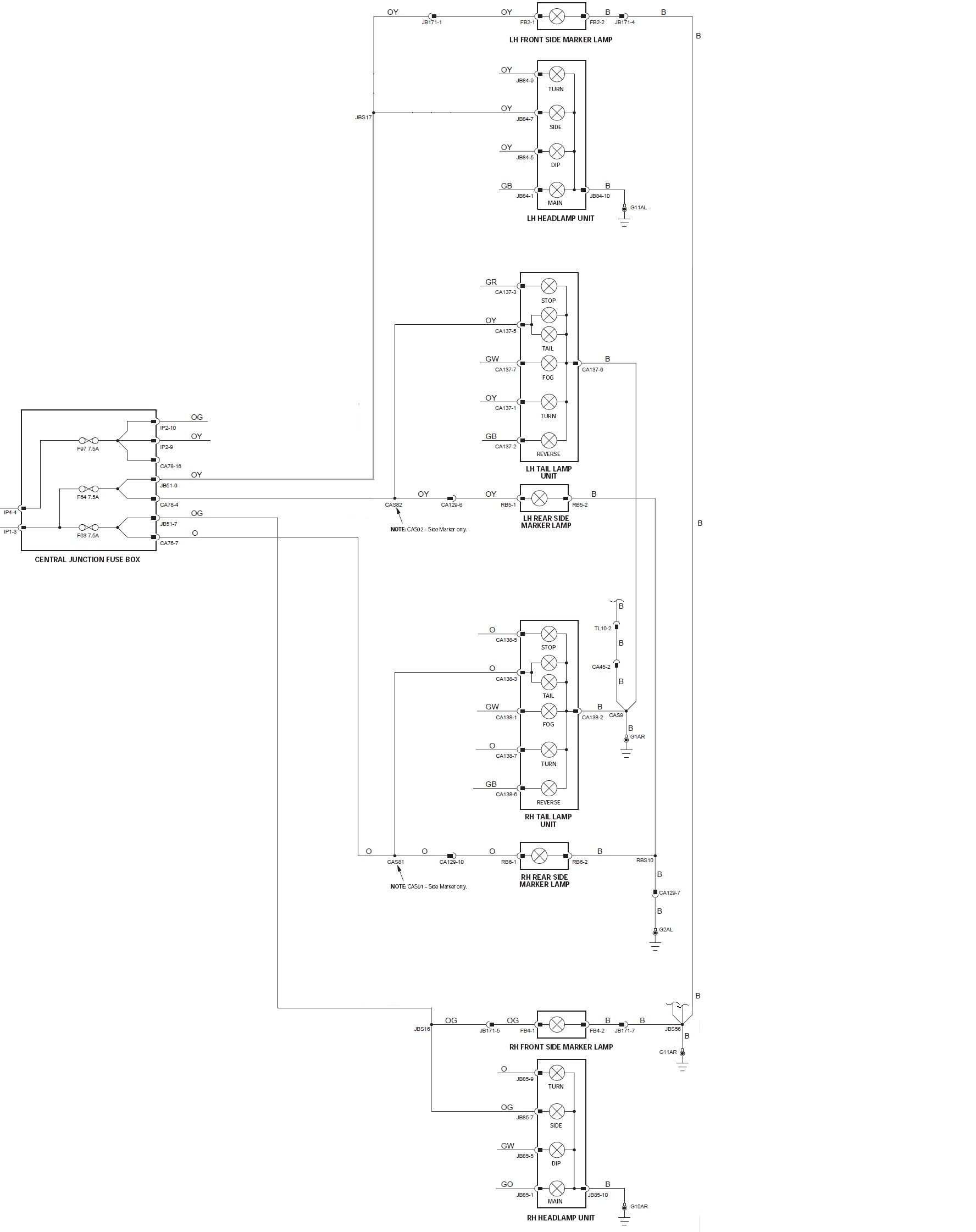

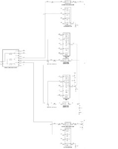

Here is an electrical drawing that isolates the wires and connections for the two circuits involved with the parking lights from the fuse box to ground.
Click on drawing once to open it then click on it again to zoom in.
Good luck tracing down the short(s)..
Hope this helps.
