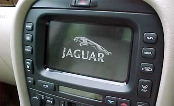

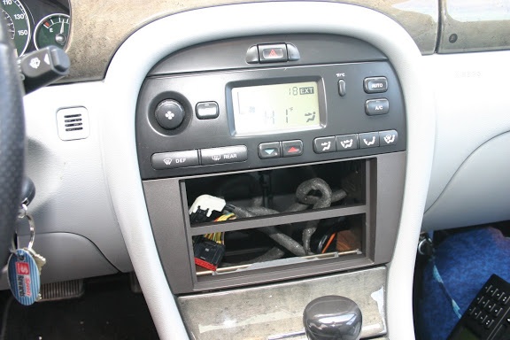

Thermo, Yeah hard to describe but I finally uploaded a picture, this first one with the touch screen is how my jaguar exactly looked. But I'm trying to get the climate control unit like the second picture instead of how they were factory made on the side of the radio in the first picture.
This is how I'm trying to get my climate control unit to look like instead of the way it is all on the sides of the first picture thermo. Btw these aren't my cars just reference

jagboy, you are looking at going from the automatic controls to the manual controls. Unfortuantely, that is a lot of reworking of the dash in the way of wiring and whatnot. It is not a simple "unplug from here and plug it in there".
How are you with wiring? I could send you the diagrams and then you can see what all would need to be done in the way of relocating things. If I remember right, you are looking at having to pull pins from out of a connector and move them to new spots and other stuff like that.
jagboy, PM me your e-mail addy and I will send you the diagrams for your car. Please include the year of your car. If it is an o4, then look in the driver's door jam and include the month/year of manufacture as the wiring changed mid year in 2004.
