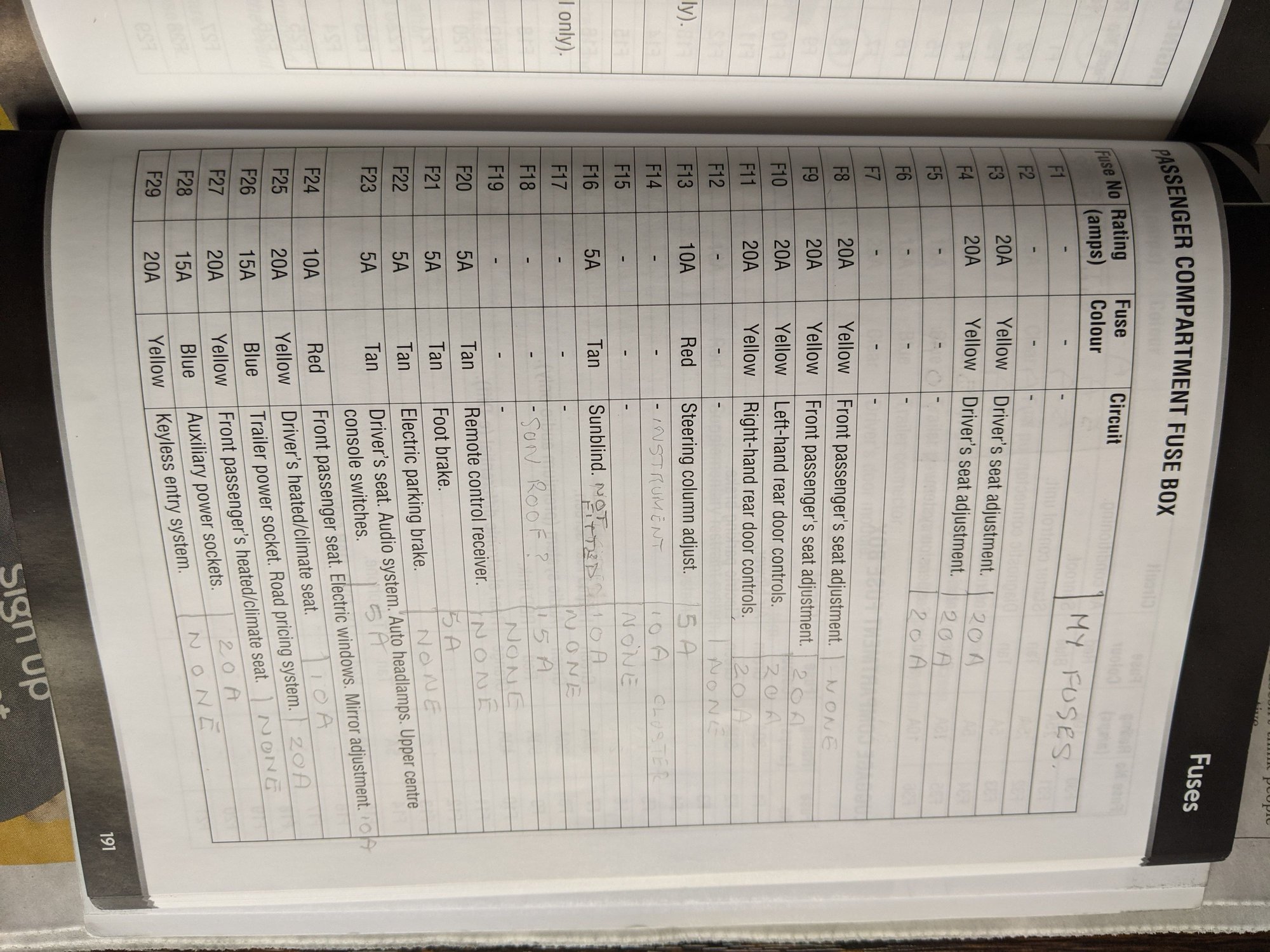

I hope you can help me to find the fuse that powers the 12v sockets in the console, i would like to piggyback the apropriate fuse to power two dashcams.
please dont refer me to this xf fuse link as the fuses in my cjb do not match the fuses in that or my manual .
regards

Posts: 2,941
Likes: 1,511
From: New Zealand
This is for a 2011 UK car so hopefully matches yours.

From: Southend, Essex
The socket under the lid in the consul is fused as "Auxilary power" Where the socket in the front of the consul is fused as "Cigar lighter".

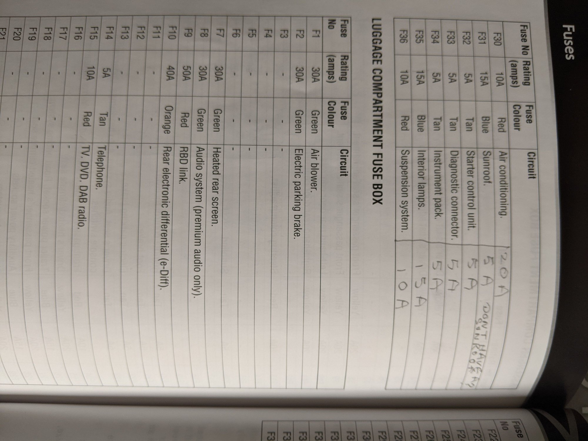

Default My CJB
Hi Norri
Thanks for the info but I still have anomilies with the fuses I have in my fusebox.
This is what I have, another question is which fuses stay live when the stop/start system kicks in, Sorry for all the questions but its hard to check that when it happens.
