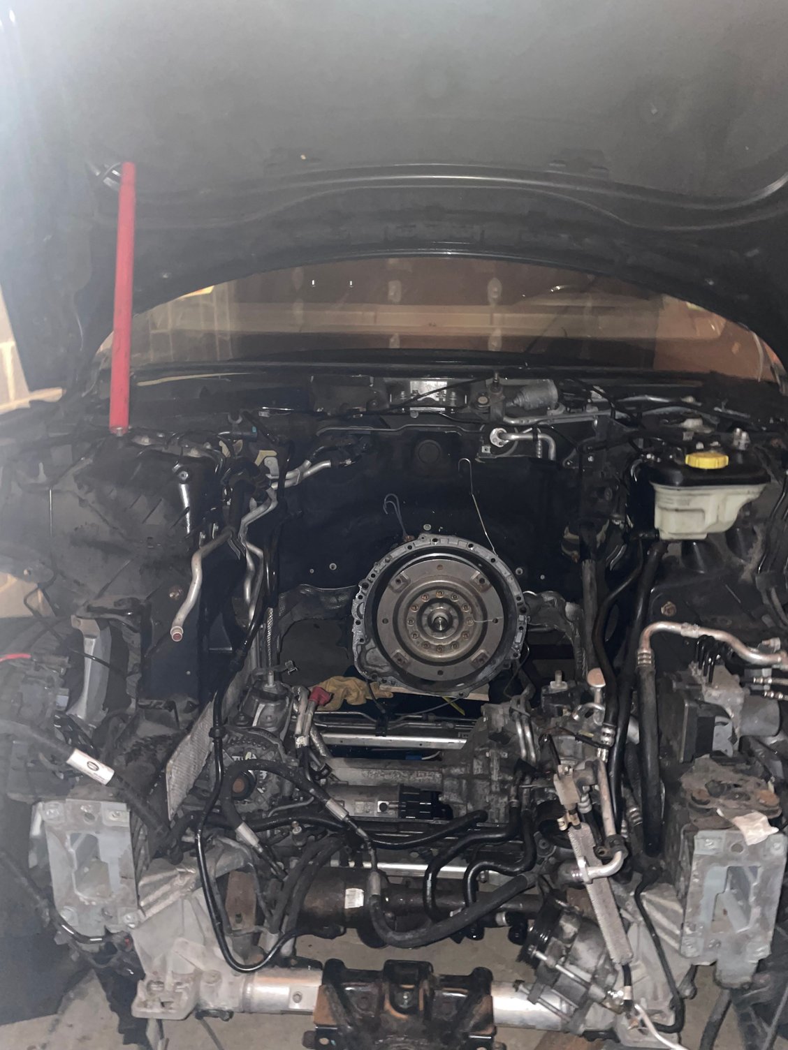

I’m pulling the 5.0 SC engine and already removed 11 bellhousing bolts + 2 starter bolts + 4 torque converter bolts. Starter is off.
When I lift with the cherry picker, the transmission comes up with the engine - there’s zero gap between them. I can see the alignment dowels, and they’re rusty.
Could corrosion on the dowels really hold it that tight?

You need to move the engine away from the transmission before you start lifting. Shouldn't take too much effort to pry them apart if you have all the bolts out.

There’s no gap at all between the engine and transmission - not even paper thin. I can’t get anything in there to pry.

yes lol
propane torch on the dowel area it will let go

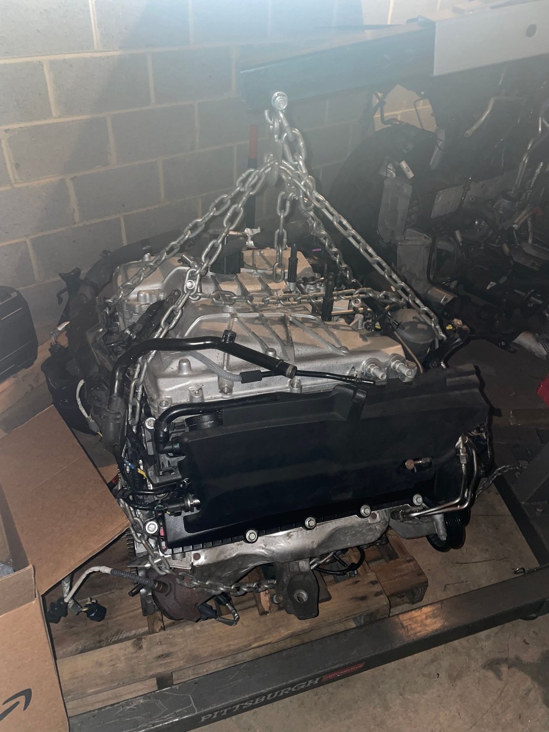

After heating the dowel area with a heat gun, I started driving the putty knife in with a hammer. Little by little, I widened the gap until I could fit a screwdriver in. After about 8 hours of struggling, I finally got the engine out!

Thanks. To add some more colors: it’s being done in a storage unit…
Now need to bring it to my place and learn how to rebuild that thing. Good luck to me 😀
