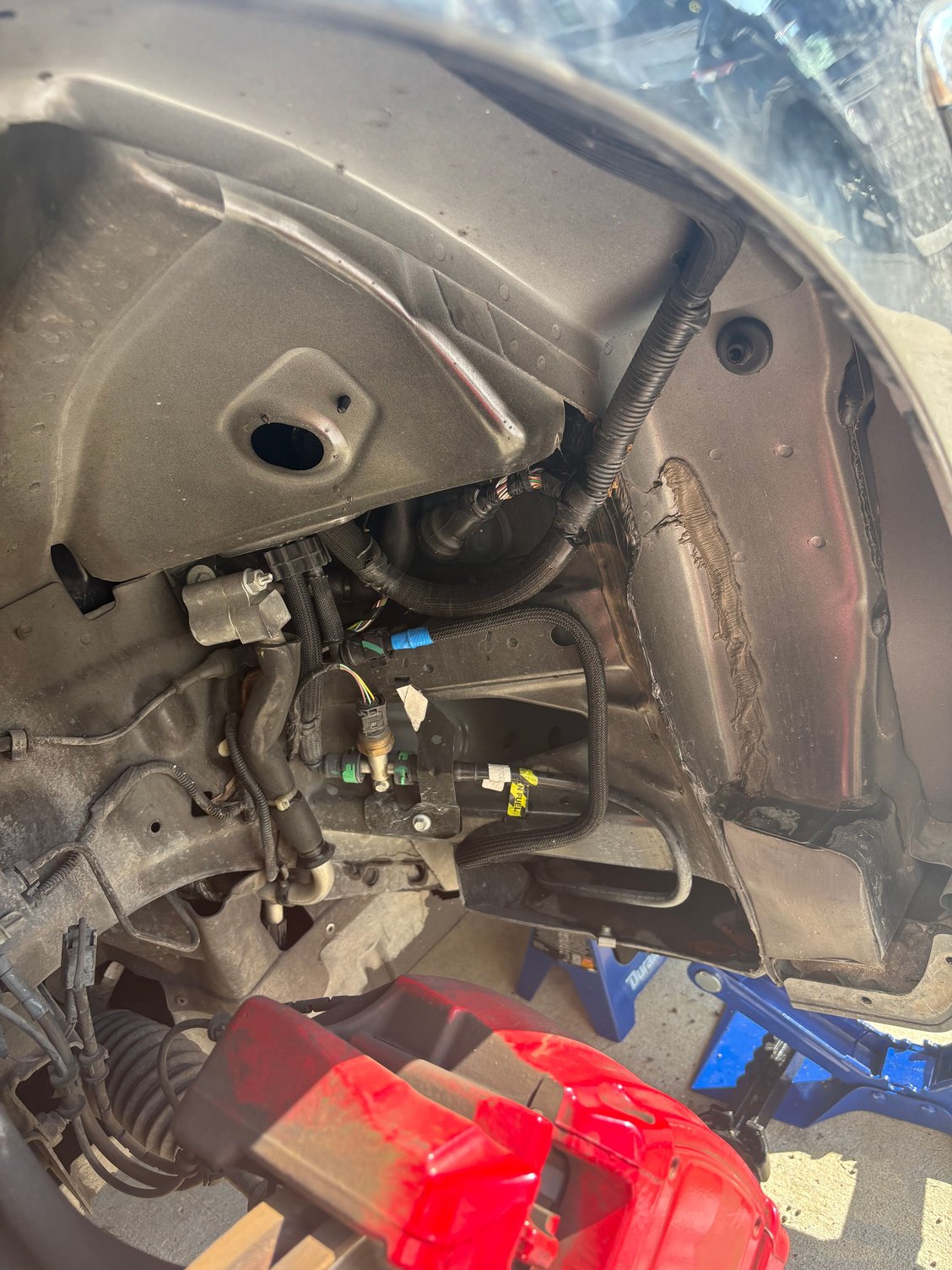

Update. Got driver wheel and arch liner off, poked around. Found that water drains directly into the pictured area, which seems like bad design, but I’m not sure if it’s really the cause of the issue.
Tomorrow I’m gonna look for the engine ground strap and check its condition. Any ideas where exactly it is? I haven’t been able to find a solid answer anywhere.
