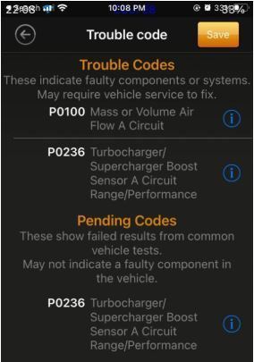

Hooked up an OBD2 reader and the below codes popped up. I cleared the codes, reset the transmission twice and still the issue persists. The car has lost its power during driving from what i can feel.

It doesn't have any way to drive properly until those are fixed. There probably is NO trans issue, just engine one(s).

Hi Shiv and thanks for posting more info. We like to help but are all just guessing on the internet!
We don't have a lot of members with the 2.0 L engine so I am not familiar with it's problems.
The code is pointing to a turbo problem but the most common Jaguar engines are SC so again not much if any experience with the turbo versions.
I agree with JagV8 it's most likely an engine problem and not a transmission problem as you have zero transmission error codes.
With the miles on the car you are just barely at the mileage I would change and service the transmission. You can probably wait a while to do that.
