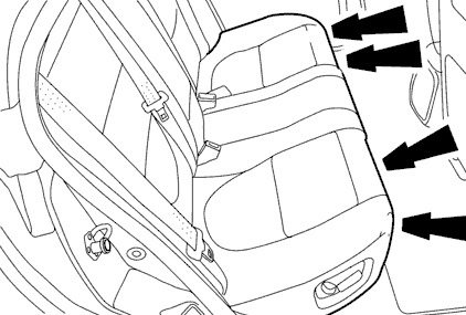

I'm another who has not removed an X351 rear seat base but would expect the fixing method would be similar in principle to all the earlier models.
This is the previous XJ model:
For fifty years Jaguar rear seat bases have been secured with screws through clips beneath the front lip. Once the screws are removed, the front edge can be lifted and the seat base pulled forwards to clear the seat back. Have you checked here on the X351?

The X351 seat differs from previous models there are no screws holding the seat base down, the creak is definately the seat back, just sitting in it drives you mad !
Any more info welcomed.
