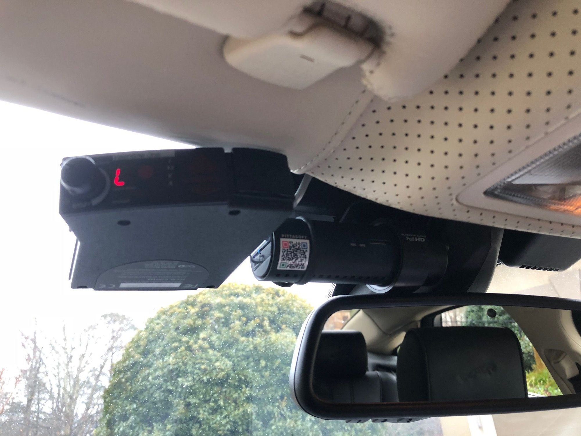

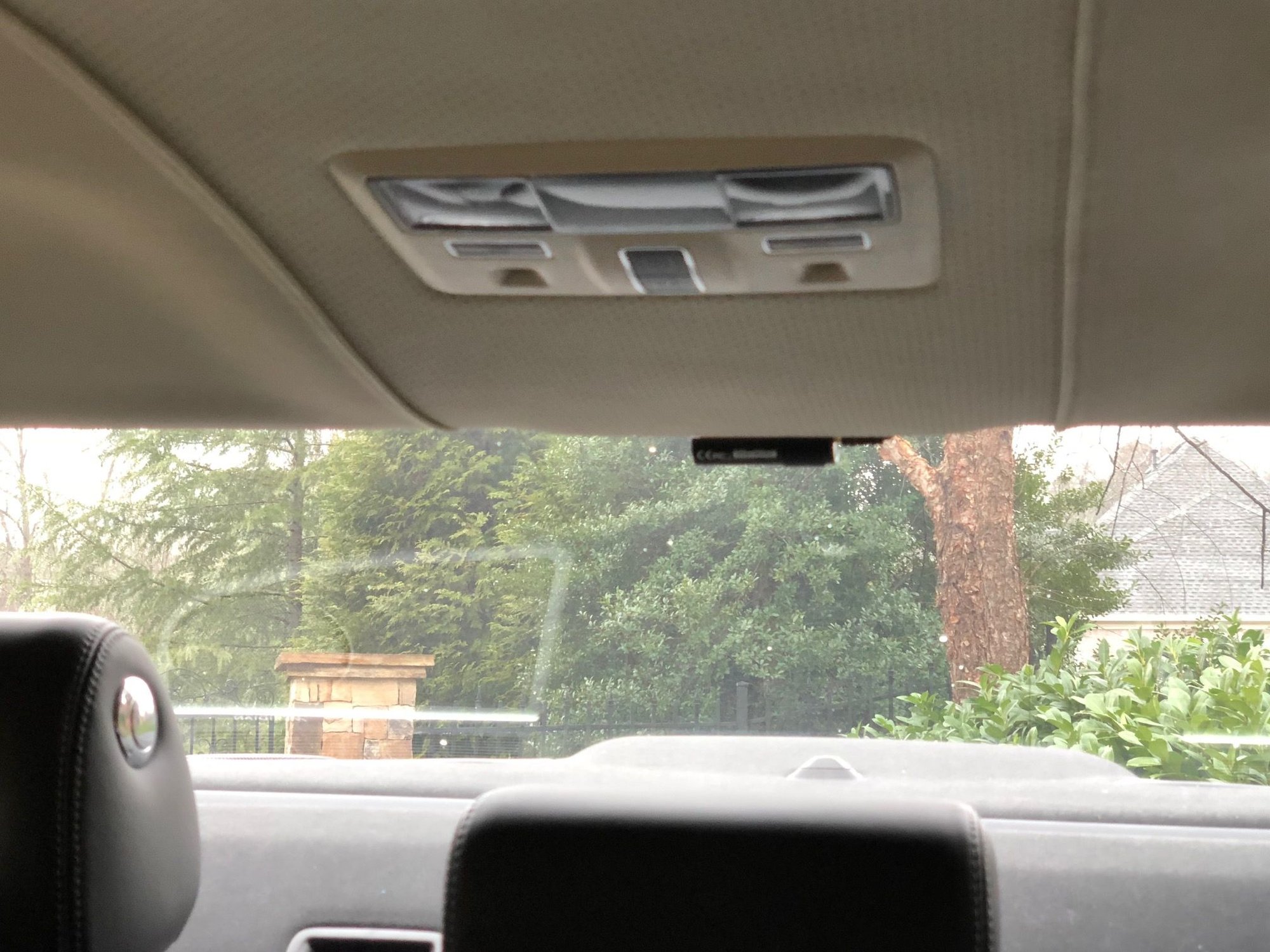

From: Chicago
Originally Posted by XJsss
As you, I do not like to cut up my cars. The only mods I have electrically are wiring in the Valentine 1 and trhe dash cams. The Valaentine was done by the tech at the dealership and the dash cams were done by the only dealer authorized installer of addons by the dealership.
Hey man, do you have any examples of your videos from the dashcams? What brand did you get and what did the dealer charge you to install? I've spent hours on Amazon looking at different ones but they all look Chinese and not very good quality. Also what's the Valentine1 thing?

Old Nov 15, 2019 | 10:13 AM
XJsss's Avatar
Posts: 1,827
Likes: 522
The dash cam is by Blackvue DR650-2CH and I purchased it @ the dash cam store https://www.thedashcamstore.com/ . There are newer models and the top of the line is DR900S-2CH. The installer charged me $250 but that was 6 years ago. The imagery on mine is very good, but the newer models are up to 4K. My unit is very dependable except I have replaced the Micro SD card with Lexar High-Performance 633X 128GB MicroSDXC UHS-I Card. ($16.49 on amazon). The newer models will support up to 256GB. It is imperative that the micro be an "XC" type. The Valentine1 ( Radar and Laser Detectors | Valentine One | Radar Detectors) is IMHO the best radar/laser detector. I've had them for many years (I do get them updated) and never had a speeding ticket and I do not drive slow.
