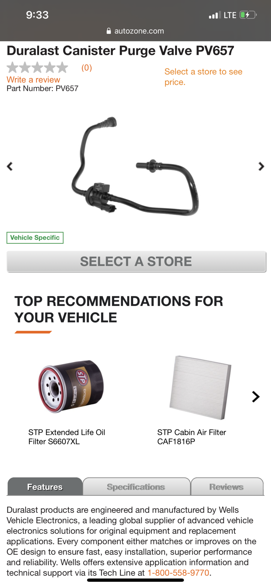

Awesome. May I ask why you did the purge valve previously? My understanding is our XJs have it inside and you have to pull the valve covers to get to it. Did you replace to fix a problem you were having? Just wondering what PCV life is/should be.

This is the purge valve I’m describing. It’s the plastic line that runs on top of the intake and connects on top front of it. It has a valve on it that was stopped up. I started to smell fuel and had bad mileage. I can’t remember the code but it said purge valve.
