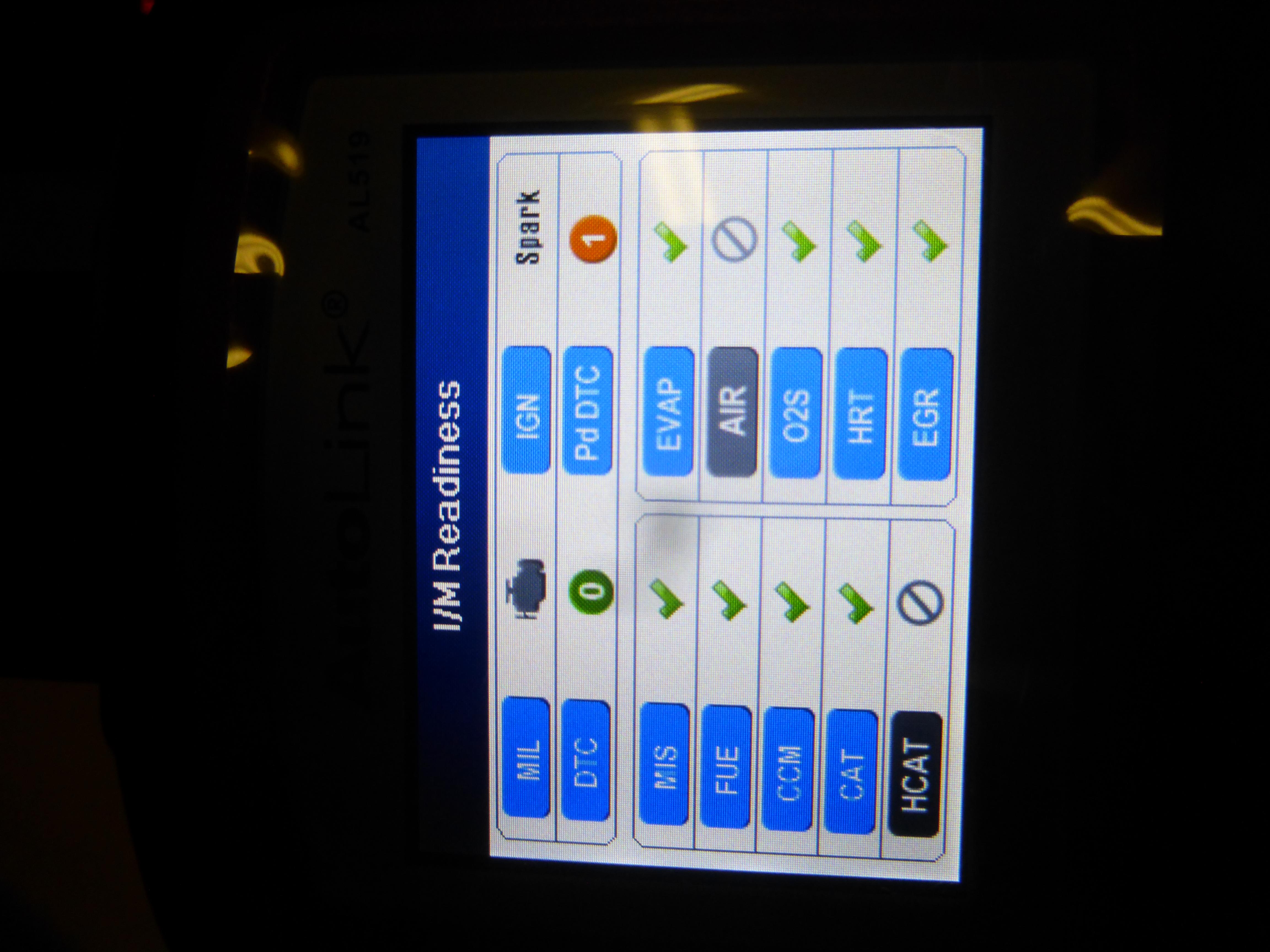

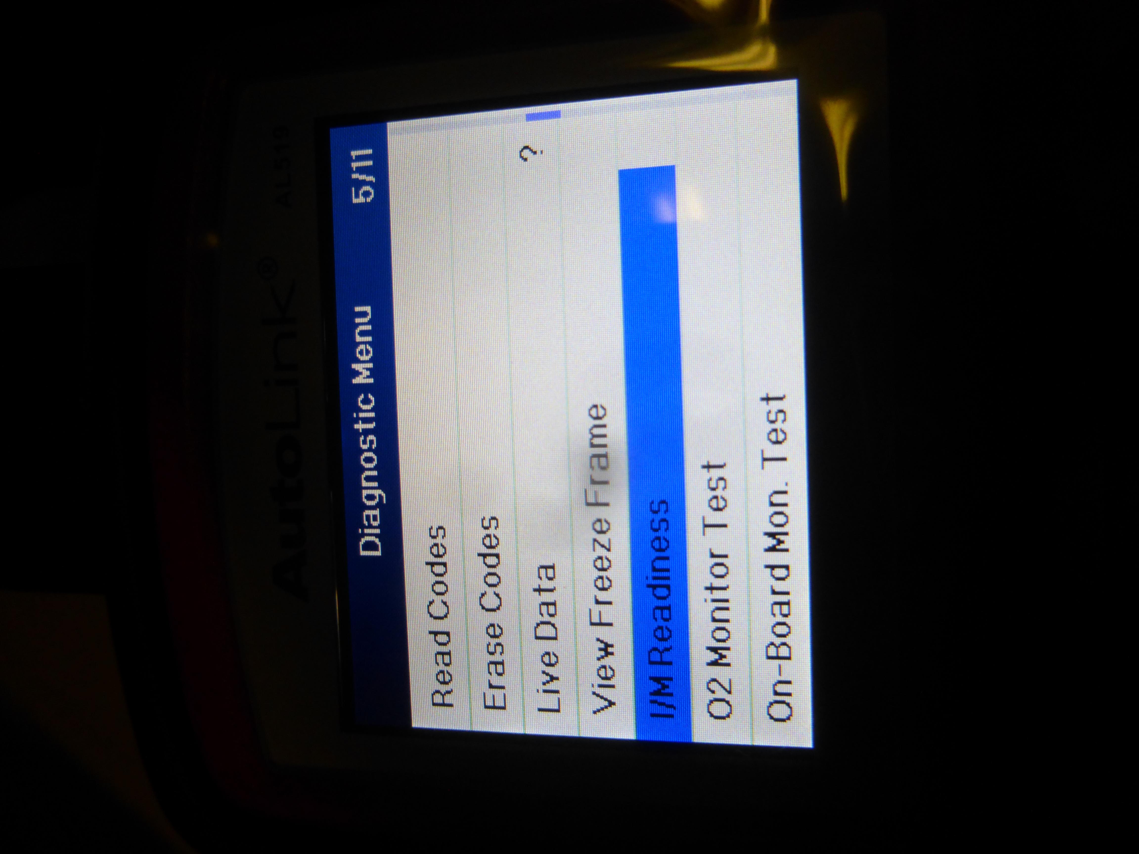

I keep an inexpensive scan tool plugged in to the diagnostic port when setting the I/M Readiness tests. I use an AL 519,about $60 US, which works on all my cars. It is easy to check your progress.
I just plugged it into my 2004 Vanden Plas and took a couple of screens for you to look at. You can see that all the required tests have green ticks (showing ready) If the test was not ready there would be a red cross there.
(Note I have a pending code showing --just happens to be the intake air sensor reading high.)
