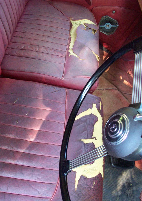

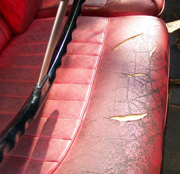

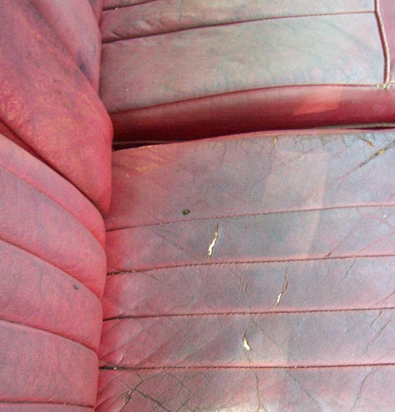

The first of the photos below is an earlier one showing the seats sometime before I "rejuvenated" them, and the others show the progression and aftermath. Leatherique claimed that the leather must have absorbed oil from the legs of folks sitting on the seats in shorts, but if that was the case the driver must have slipped his off and gotten bum oil on the pleats near the seat back too. Leatherique never accepted any responsibility for what happened to these seats and to my knowledge have never changed their claim that their product can not possibly harm old dry leather.

I too was a believer in Leatherique. But my XJ-40 seats were in great condition. Long gone is the heavy thick Connolly leather from old. I am now sold on Gliptones concept. No harsh solvents used, and a better system for modern leather.
As to the splitting of your seats. Due to the level of damage and depth of cracking, most likely ANY moisture induced to the leather (including water) would soften, but then shrink some when dry and cause the splitting to the weakest areas. Think of it as shocking the leather fibers. With with new leather recovering, a steamer is used ay times to relax the fibers, to shrink wrinkles, and then the leather shrinks and forms a little to pull it tight.
I've been doing interior mfg for many years, and would not have given those seats a very good chance of survival from restoration alone. I haven't come across a product that would have been very successfull at bringing those seats back from the dead. It has been done with Leatherique and Gliptone, but not from that level.
