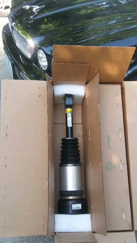

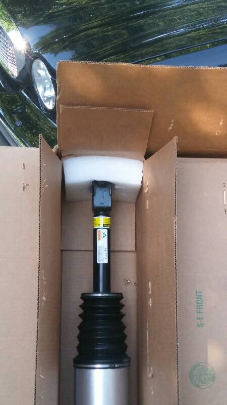

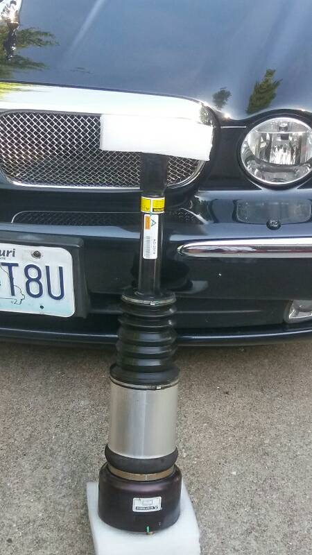

Semi-Local Craigs list guy has two front air shocks and one rear for sale from swapping out the suspension on a 55k mile 08 XJ8 VDP. Wants $500 for the front pair or $600 for all three.
I know it is a risk to buy used; even if there's "only" 55K miles on them, they are still 8 to 9 years old. What do you guys think? Replace my year old Arnotts in the front to see if the clunk goes away? Then keep the Arnotts and one rear for future replacement/insurance? Offer $400 for the fronts only? Or just live with the clunk until I can check the front shock bottom bushings? Would I notice any big difference with the front ECATS working again?

I didn't know that any Arnottts maintained the ECATS system. I thought that they just had a resister or whatever is needed to fool the system into not throwing codes. The ends are covered in the pics, so I'd have to ask.

Hi Phil,
If those are OE Bilstein air springs/shocks that Arnott rebuilt, they should retain the ECATS capability. I don't believe Arnott did anything to affect the solenoid valves in the tops of the shocks.
If they are the proprietary Arnott units, they do not have ECATS capability.

If you are having a low suspension fault and need to get the car roadworthy again I have a couple of used air struts (front, rear) for sale in the Classifieds section. From my own purchasing experience I think the fronts are overpriced by $150 or so, especially if off of a 2004 car,
The ad said from a 2008 with 55K miles. My car is OK for the time being - it just has a clunk on both sides that might be bushings or (from others experience reported here) might be the Arnotts that were put on the front when I bought it a year ago.
I see new Arnotts are $550 plus shipping (the craigs list ad says new are $700) so he is asking about half of new. Guess I'll call and ask if they are rebuilt or if they are Arnott manufactured units without ECATS. He didn't say, but I suspect one rear went bad and he replaced all with coil over units, probably also from Arnott - hence the new boxes in his photos.

Is your O6SV8 a Soverign (supercharged) V8? If so it may be equipped with the XJR type, stiffer shocks
The struts you have in the pictures above sure look like Arnott's to me, and I've had 04, 06, 08 and 09 factory air struts in front of me at one point or another over the last year.
Yes, they looked like Arnotts to me too, although the rubber covers have fewer and larger corrugations than the new ones on the Arnott web site.
Yes, my SV8 is supercharged, but I think the LWB sedans got the comfort suspension and I think the new Arnotts are valved for the comfort setting which may be why they recommend replacement in pairs.

Those are Arnott Designed Struts AS-2519 which were sold in pairs. They were superseded by part number AS-2710 in 2014 with the only difference being they were sold separately. They have been recently superseded again by AS-2888 which was valved for vehicles with Comfort Suspensions ($552.34 Retail) and soon to be released AS-2890 which will be for Sport Suspensions. They bypass the ECATS functionality but provide an excellent ride.
