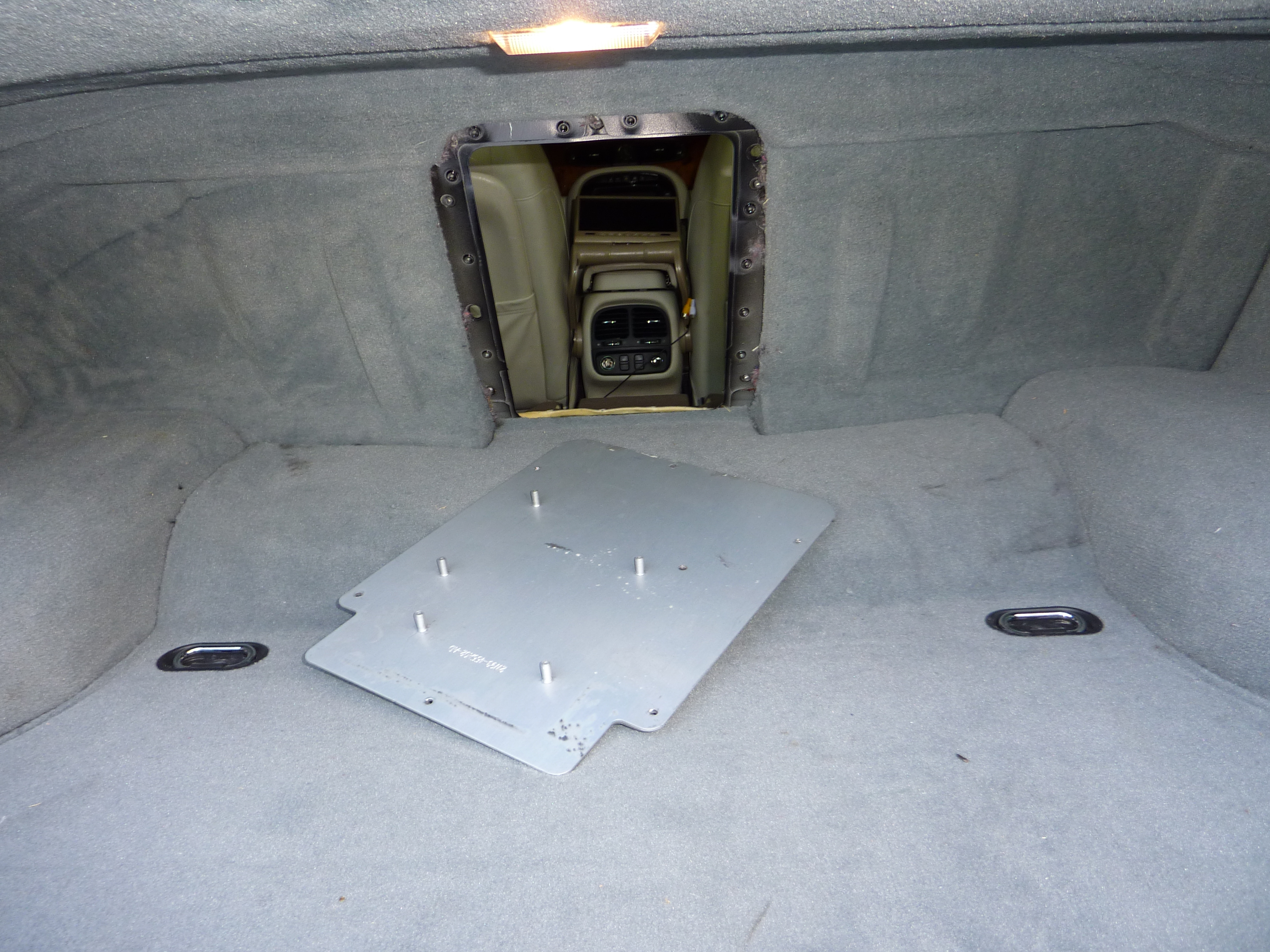

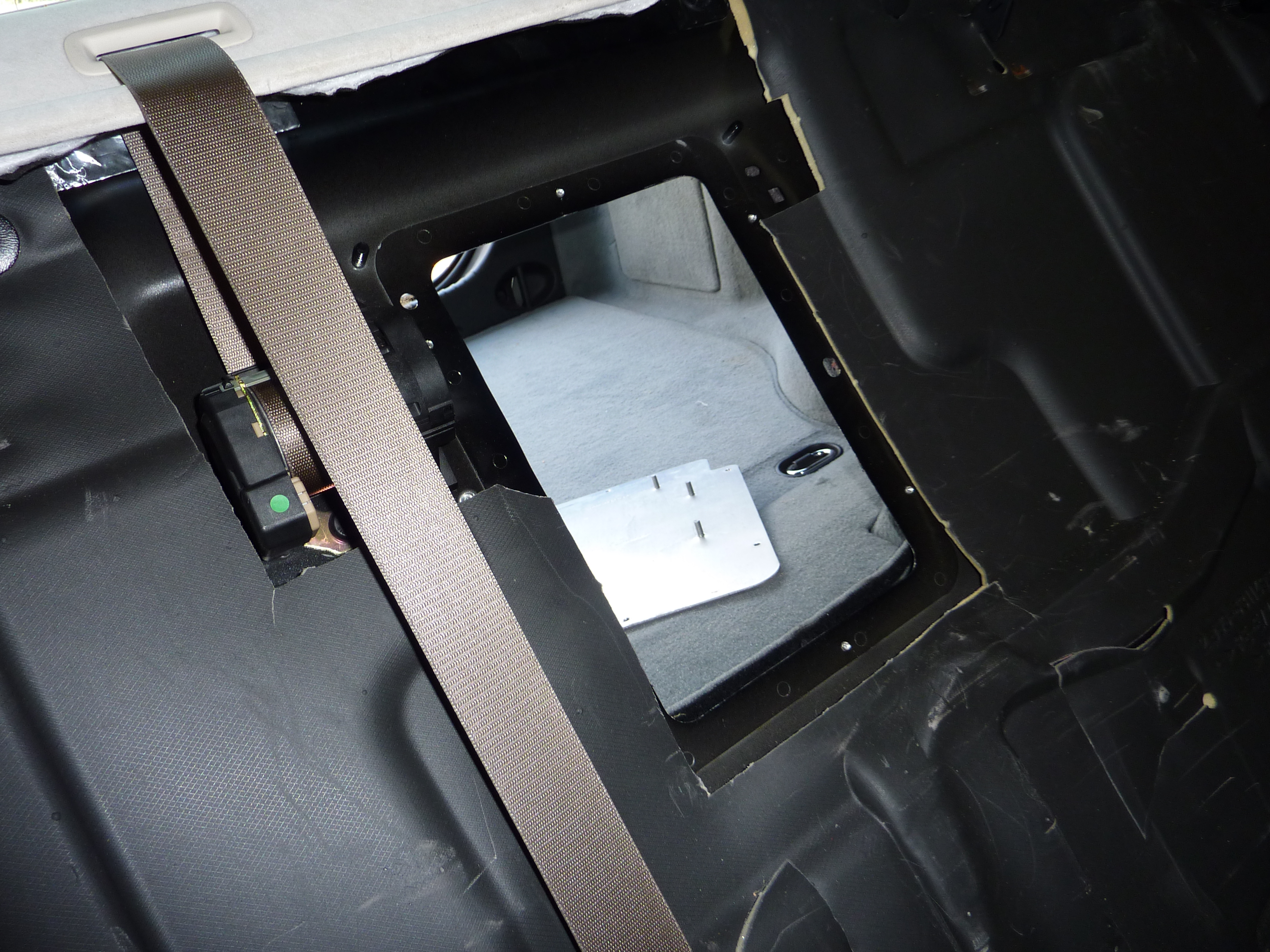

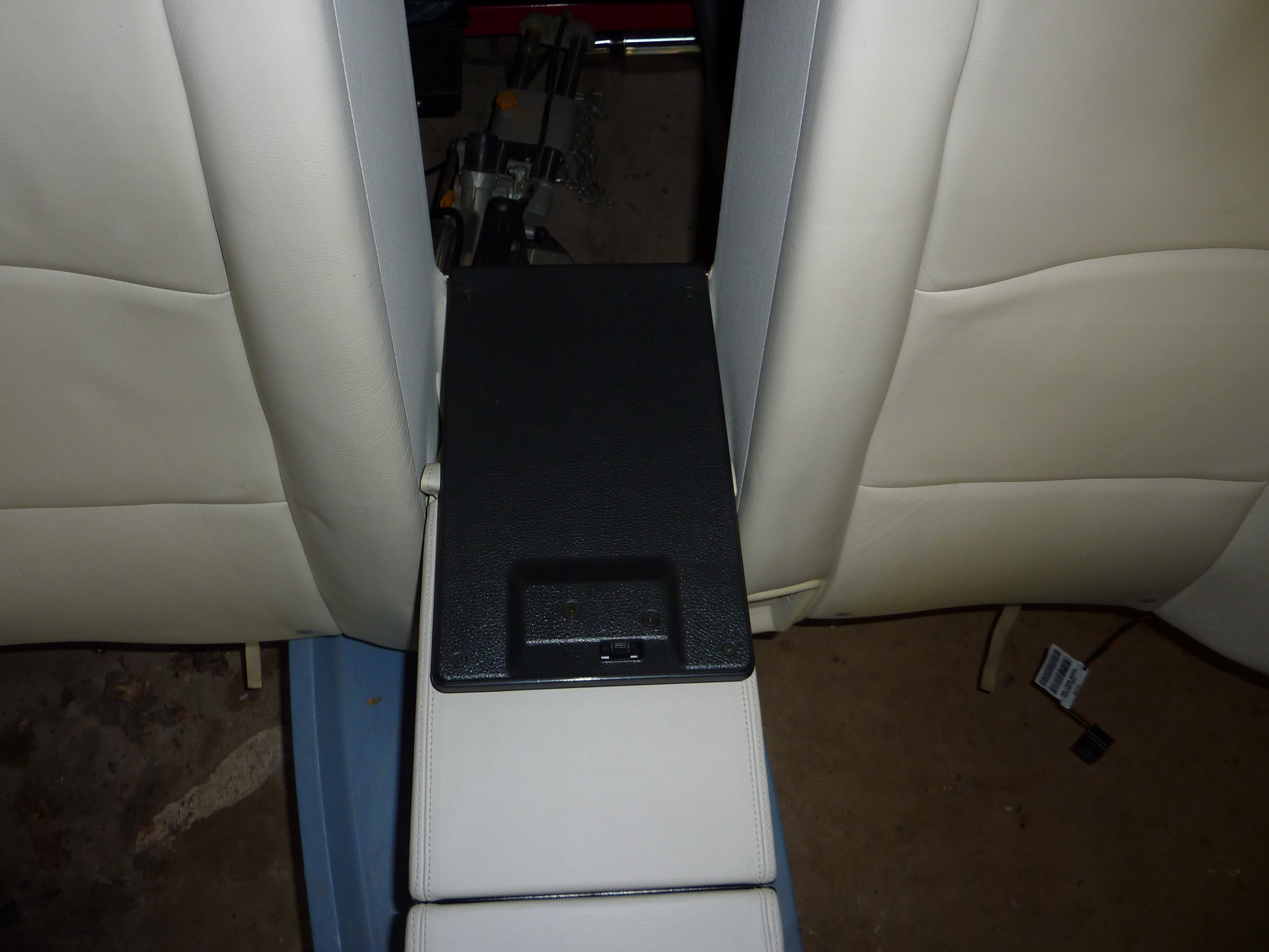

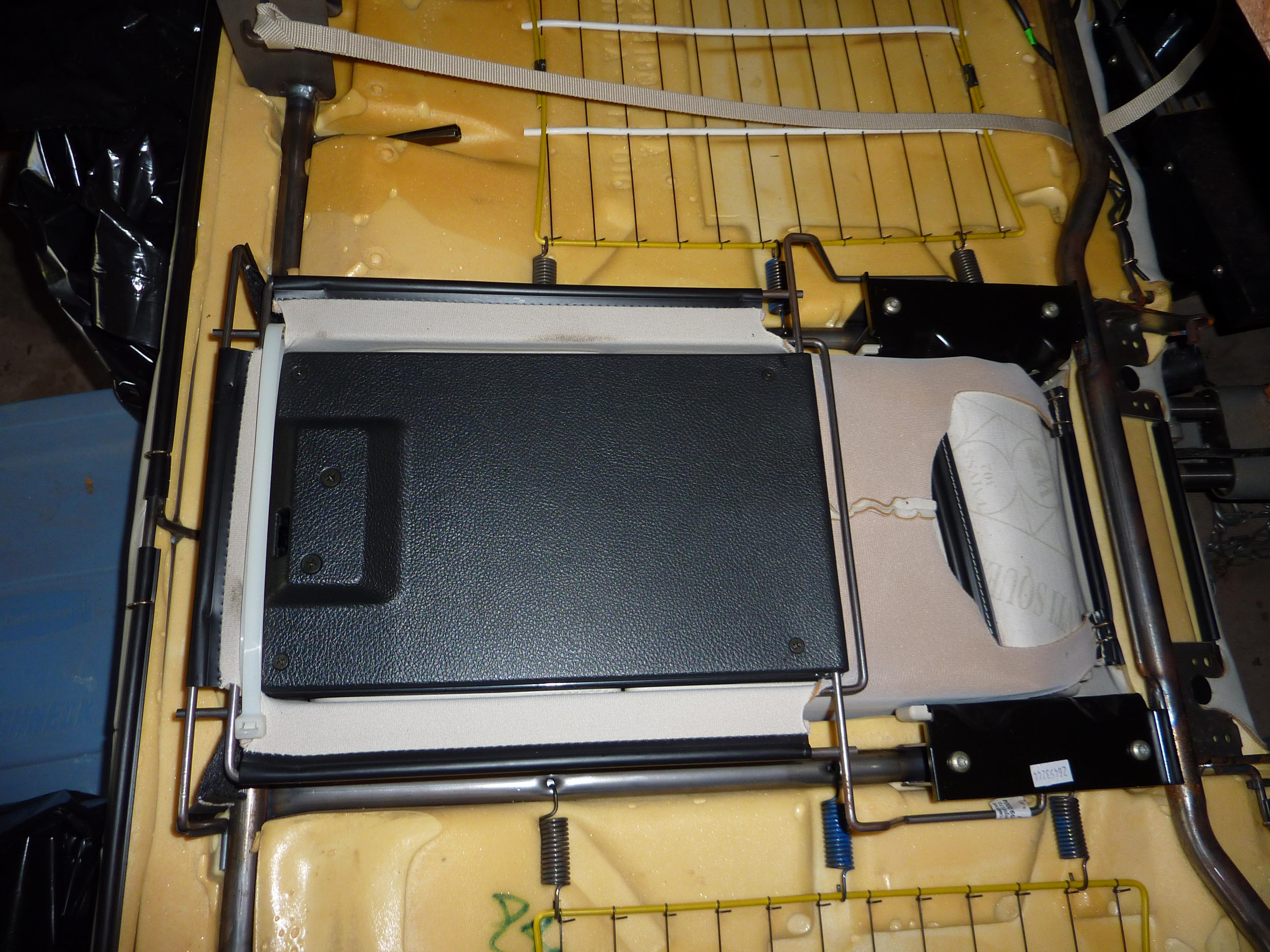

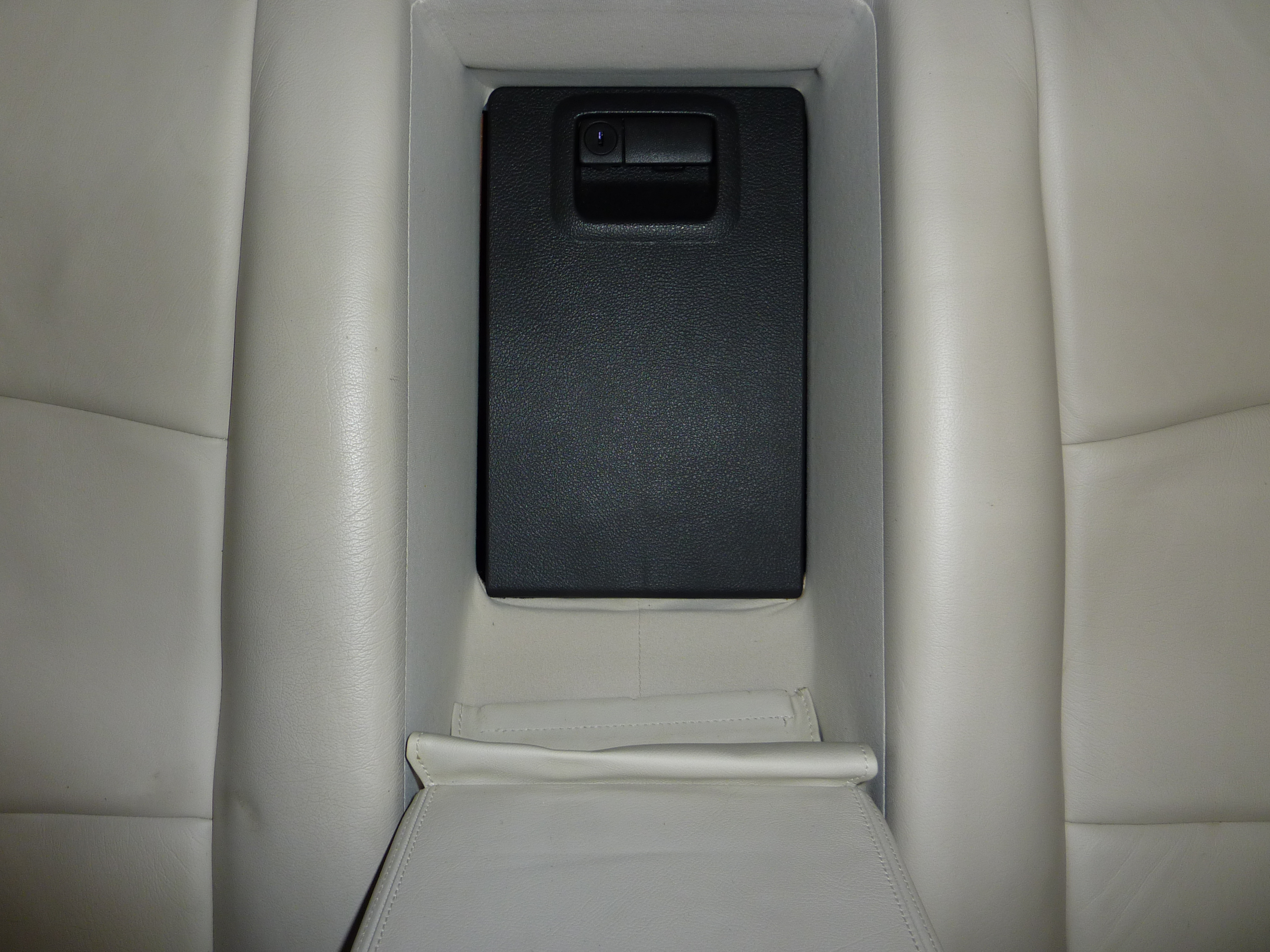

Joined: Aug 2014
Posts: 6,264
Likes: 1,764
Default Ski hatch project
Originally Posted by PeteK812
Hey, jackra_1, how about some photos and a description of the ski-hatch project?
Some pics as requested.
Spent a lot of time trying to figure out how to install the whole ski hatch from some other car.
Ended up just modifying the swing hatch itself to attach to a metal bar in the rear seat.
It does not lock because of that however serves the purpose I had in mind for fishing rods.
I used a white pull strap to stop the hatch swinging back into the trunk.
It is a "tight fit" so it will not swing forward without pulling.
Note the plate that was originally in place over the hole. Just drilled out pop rivets to remove that.
