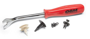

There are Christmas tree biting inserts holding in the bottom row and you use a interior trim tool to pull them out . Replacements if needed can be found at the auto part store . In a pinch a putty knife protecting the plastic with a flat blade screwdriver works to leverage them out . A cheap trim tool is at Harbor Freight as I found mine . There is one of these Christmas trees on the upper forward most point as you swing the door open . Take a sample size with you if you need to replace as they come in many sizes .

Old Dec 22, 2017 | 11:11 AM
1JerryL's Avatar
Joined: Dec 2017
Posts: 16
From: San Clemente, Ca.
Most appreciated info. Looks like this is a project for the first week of the new year.
