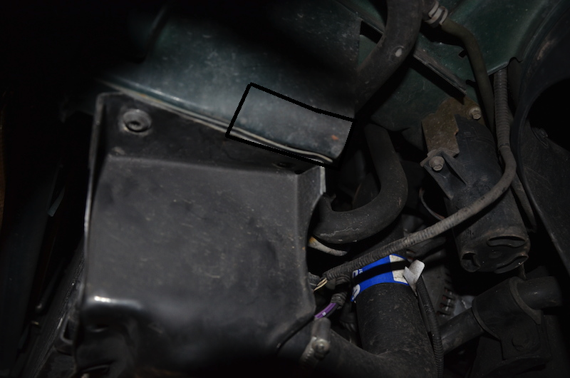

picture please

I've drawn box around the crumpled section, it looks the same on the opposite side but not as bad.
And of course the remains of the fan.

We did the exact same thing going over a tire retread that was laying in the road. No where to go and I ran right over it. I didn't notice anything was wrong until we got home and the fans would not shut off. I looked and the wiring was smushed against the one of the bars in the suspension. Long story short, our insurance company repaired it. It was a $3000 job at the best body shop in 2007. They replaced the bent rad support frame members and the rad support and the rad. They painted under there as well. I think at this point, $3k will total the car. If I were you and it was worth it to repair it, go outside of the insurance company and pay out of pocket, or see if you can bend them back to somewhat straight. Best of luck to you.
