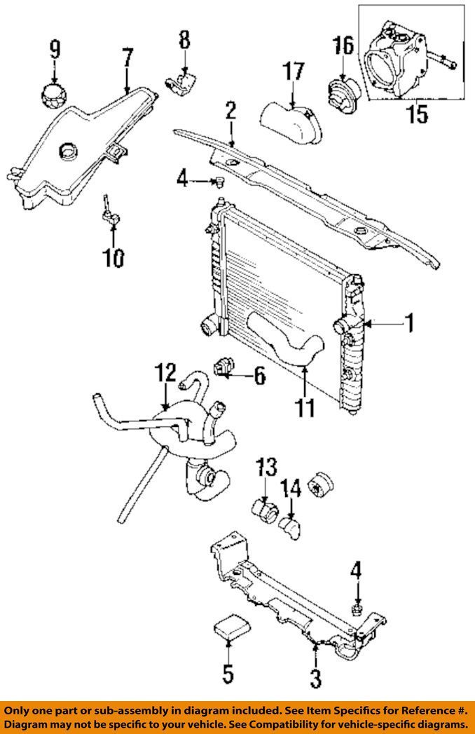

Not urgent . I removed the lower bracket by tying up the drained radiator and condenser to the upper bracket with some twine . Once removed I hit the lower bracket with a wire wheel and spray paint as the original paint was poor and rusting . The lower attach bolts are the same size as the bolts along the top before you crawl under there but will need an 6 inch extension . Important to look to see if the fluid is green or orange color or the third color I can't remember . My power steering hose was leaking which is common and had migrated onto the lower bracket . Cut off an inch of hose as it comes out of the reservoir so it has fresher material to clamp . Item and 6 and 11 ? I'll buy bushings later as all of mine are gone .

seems like not so easy to replace the lower ones. is it the same bushing part number right ? At least according to the schema number 4 is the same for upper and lower

Upper and lower radiator bushings are the same part. I went with the URO brand for these, a harder rubber than the original and hopefully will outlast the original softer bushings. They are very inexpensive. The bottom ones are a little trickier to do, I did not remove the hoses but did use a little dielectric grease on them to help slide them into place as I was prying the radiator up.
