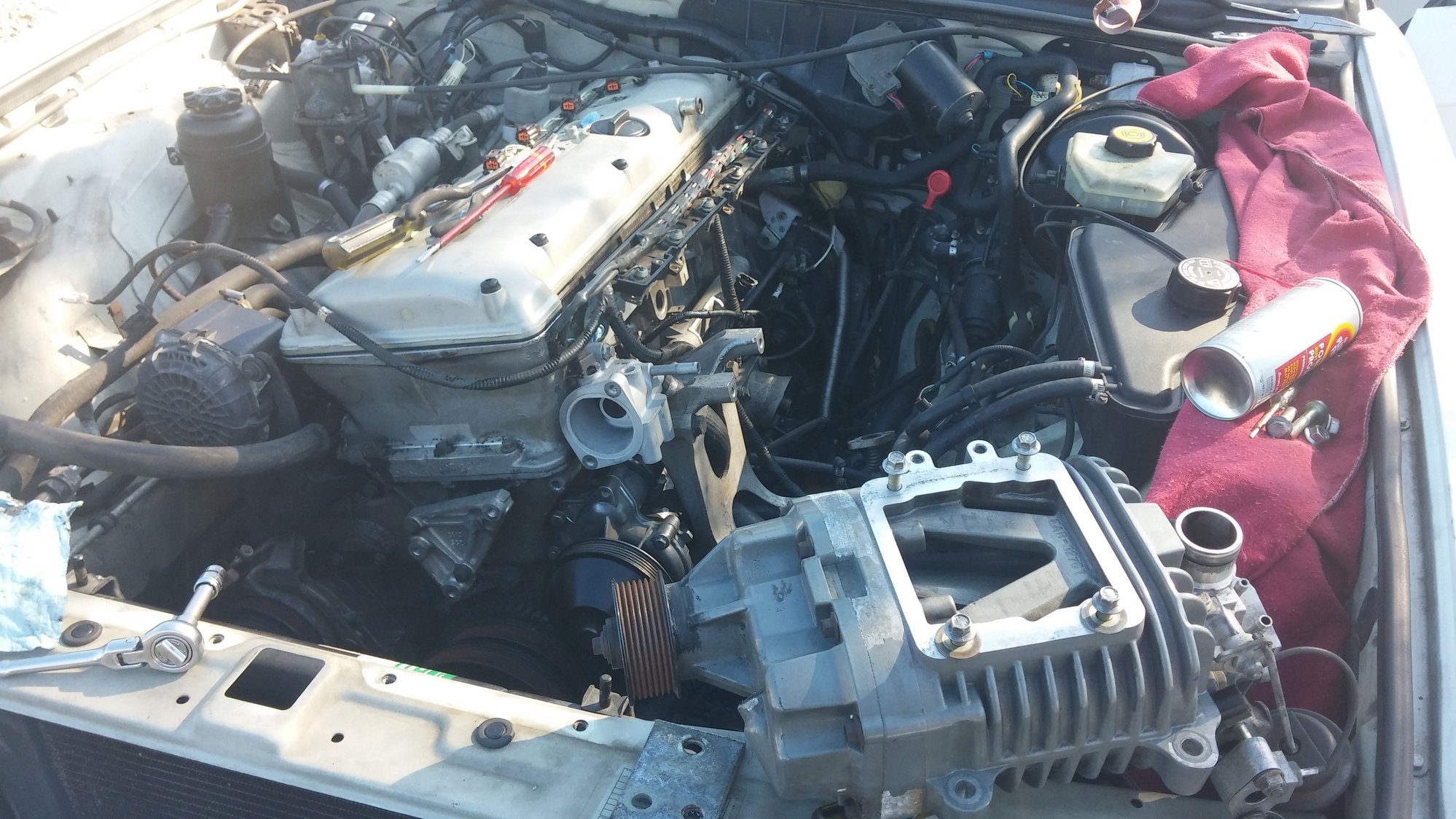

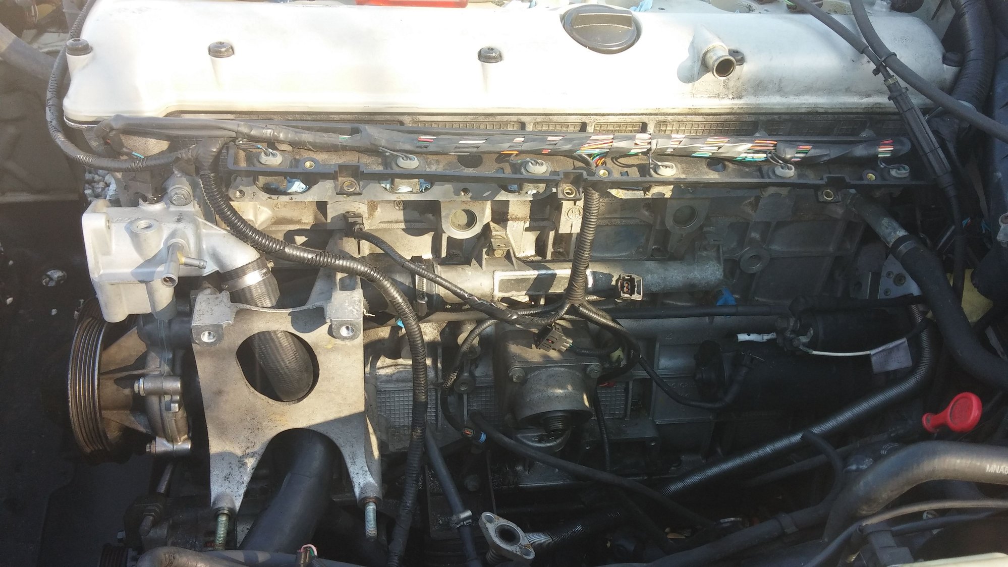

The amount of excess fuel you are describing sounds more like the TPS (throttle position sensor) out of adjustment or gone bad, engine temp when cold maybe a little extra fuel, air flow slight adjustment on the mixture but the TPS tells the ECU to pulse the injectors at a set rate in accordance to the butterfly valve position. In simple terms it thinks your wide open throttle (WOT) and is injecting fuel at WOT rate, you could try starting the engine then unplug the TPS the ECU should have a basic map for idle and see if that makes a difference or listen for the injector pulse with a mechanics stethoscope. The TPS is a bugger to get to on the XJR so good luck and keep us posted
Old Jun 20, 2015 | 08:46 AM
moff1959's Avatar
Joined: Feb 2015
Posts: 128
Likes: 41
From: Richmond VA
Throttle body item right at the front to the left
Best access it from under the car I think
The harness
