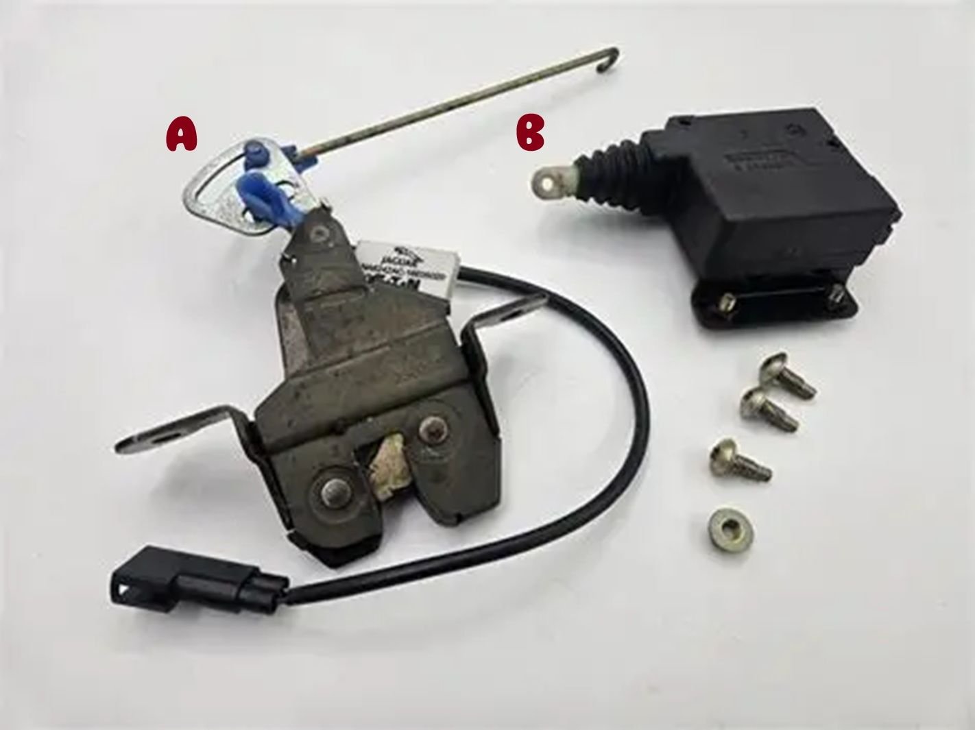

Something about elongated rod end hole the trunk release actuator ( ? )
You should be able to hear the actuator moving

You may not have to go to this extent to resolving yours , but some background information
Rear trunk release button not working - Jaguar Forums - Jaguar Enthusiasts Forum

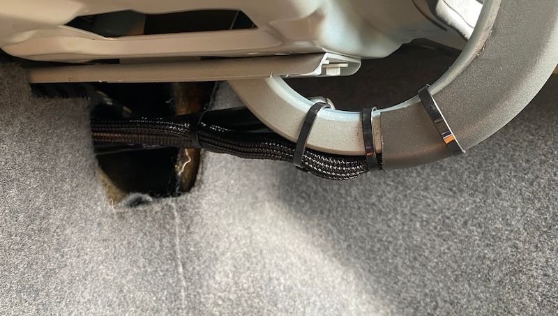

If the lamps in the boot are not illuminating when the lid is OPEN, the latch switch is probably faulty and might be in VALET MODE or the harness at the right hinge-point has faulty wiring.
The x300 wiring harness is susceptible to tearing apart at the trunk/boot hinge....due in part to the exit hole in the plastic hinge cover that tends to eat through the harness over the years. My broken wires resulted in no number plate lights, no trunk lights and the release not working. Re-connected the wires and all was good.
My ultimate solution was to cut the plastic hinge cover back as far of the harness exit hole and covering the harness with a good quality woven cable sleeve and re-attaching it to the boot/trunk gas strut.
Maybe not the most elegant solution....but I'm predicting it's not going to happen in the next 30 years
Ugly mess..luckily they're color coded...
Extended the woven cable sleeve up the hinge as far as the trunk/boot lid...that was probably unnecessary.

Looks nice to me and where did you find conduit sleeve as a short peice , at work is in 50 foot rolls

I bought it in an electronics shop...it is heat resistant woven mesh split conduit....probably bought it in a 1 metre roll from memory.
