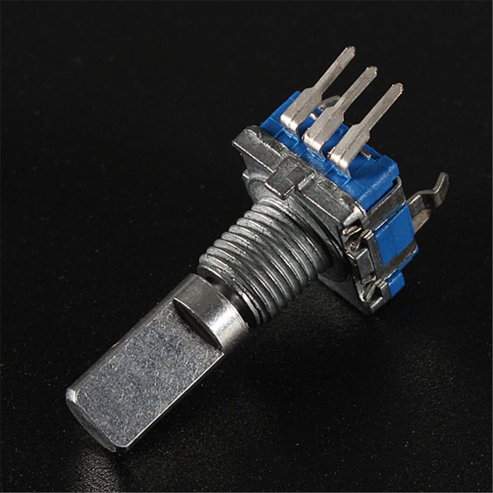

The on / off volume knob is a encoder device that can be changed
They come in different shaft sizes
The following pic is a example but not the exact size needed

See post # 8 as the Alpine / Jaguar AJ9500 stereo head is taken apart
aj9500 encoder jaguar forums

It is a full-on internal repair to replace that knob. Every AJ9500 radio has had or will have that problem. Surprised to hear one was still working until now!
One solution is to wait a day or two. The head unit will start working properly again, when it is ready.

The encoders come in the same pinout configuration but different shaft sizes so is a catalogue search through
once one is found recommend liquid soldier and a heat gun to resoldier
