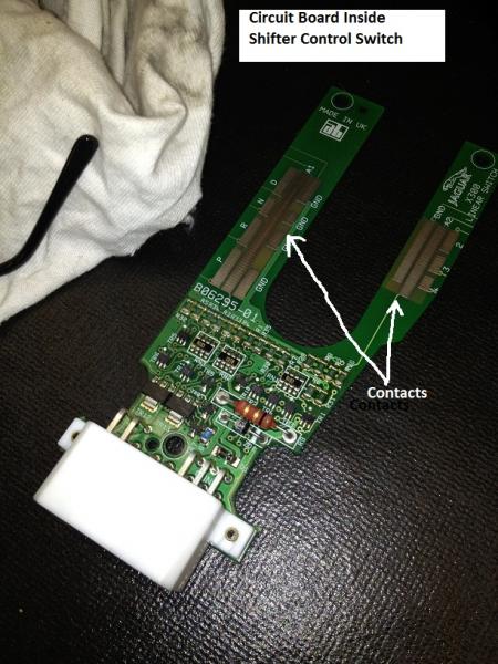

Okay here is the update. it is fixed. Thanks to my friend Hunter. We took the console and everything we needed to to get to the shifter assembly. Pictured you will see a black box, the shifter control switch, we placed the car in drive with the red D not lit up, Hunter moved the connector around on this box and the D lit up. We removed the shifter control switch and found that the connectors, shown in other picture were worn down and not making good contact, Hunter used a pointed punch to raise the connectors on the three prongs. We put it all back together and it worked so much better. It is working great now.
Hope this helps someone in the future.

Well done - not heard of this problem or fix before, thanks for the update, it adds to the forum.
