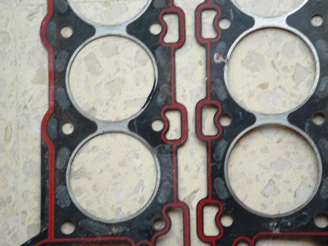

I have attached two photo's. The gasket on the right is the left bank... check out no.2 cylinder (the gaskets are upside down), I reckon this is the one that created all the symptoms, you can see the track from the fire ring to the water jacket. The gasket on the left (right hand bank) is also showing signs of tracking in almost exactly the same place same cylinder...and to think I was considering not removing this head...thanks again guys!

Just over a week ago I completed the job, I turned the key and she started almost immediately...I'm not religious but...etc. etc.
I am so grateful for the help you guys have given me... this forum has sure restored my faith in human nature!!!
