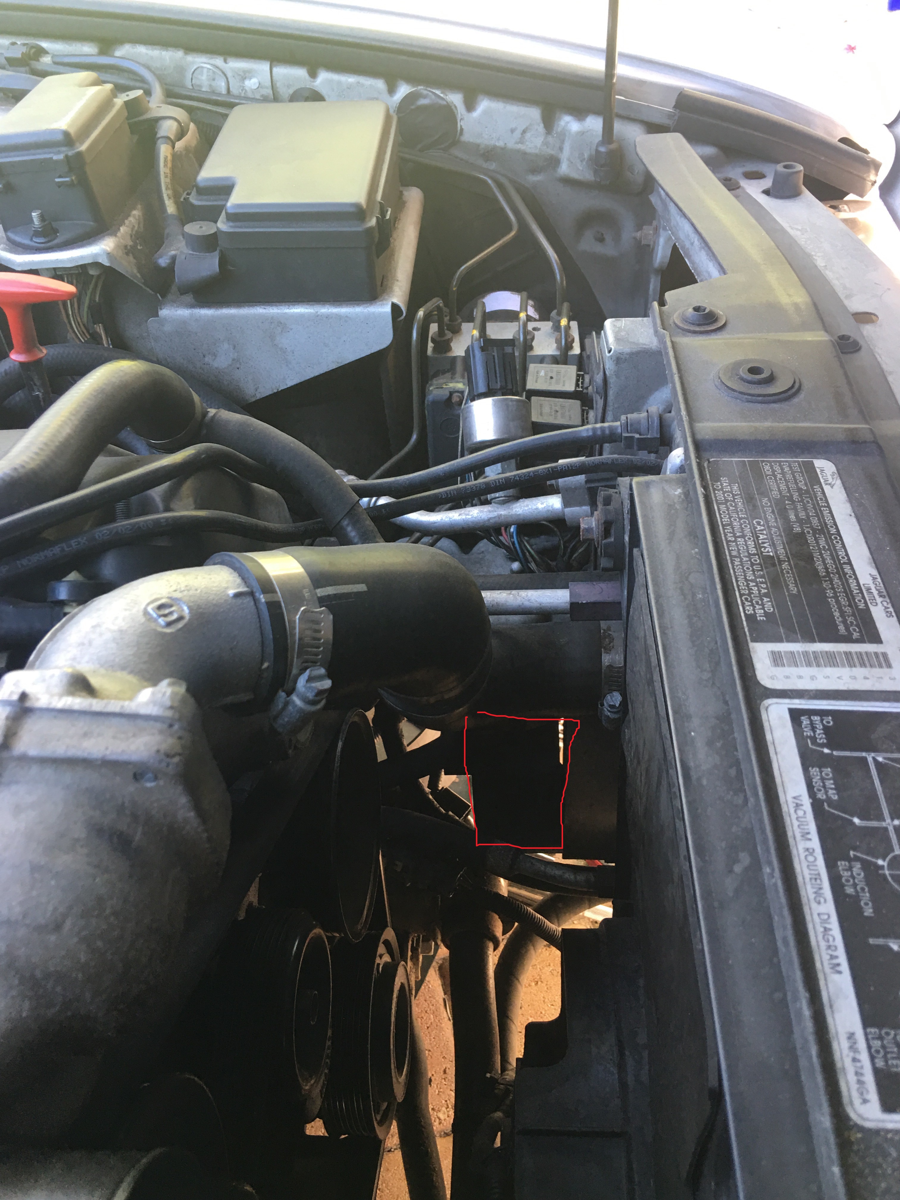

Default Pics of where sounder is on 2001 x308 XJR
ok, here is the pics of where I found it...in order to remove it, take out the two bolts that I have circled...you have to remove the front under tray and remove it from the bottom of the vehicle...it was a real pain to find it, so I hope this helps others...

Looks like mine's close to where that one is. Somewhat related, is there a way to set the sounder to chirp every time the lock button on the remote is pressed, instead of just the first time the system is locked? On my other car I rely on the repeatable locking chirp to make sure I've actually locked the car..
