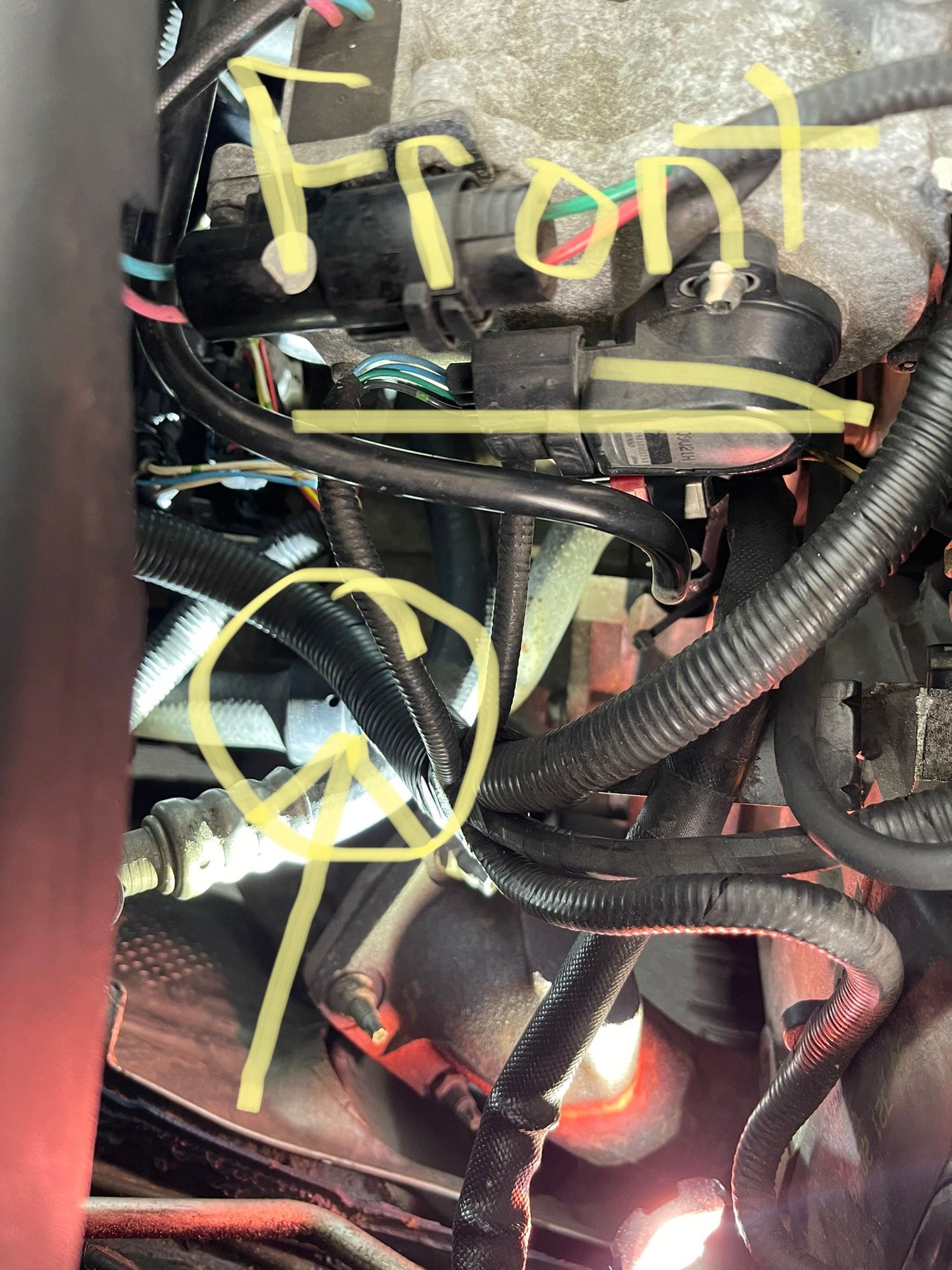

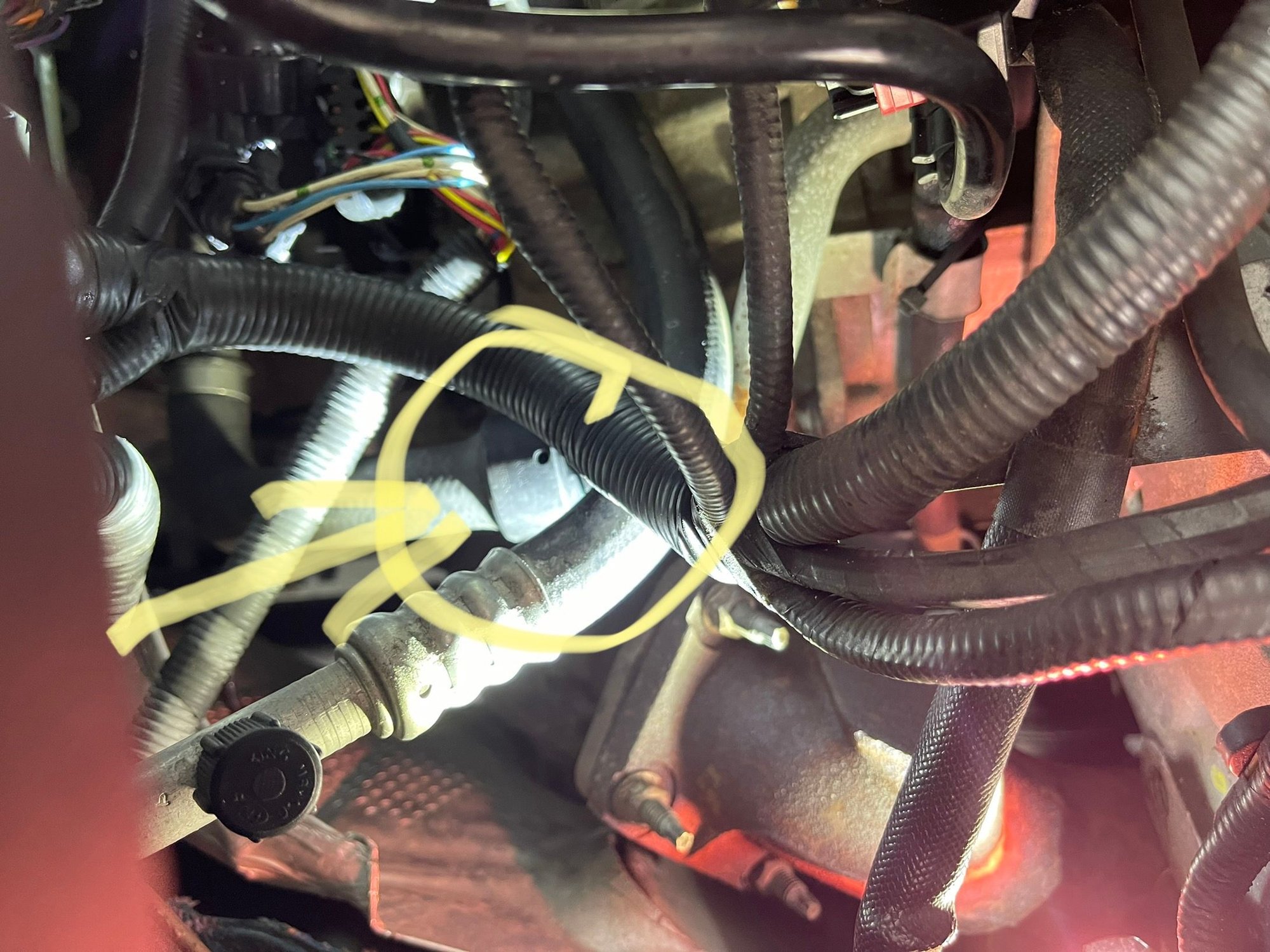

Started dripping and leaving a small puddle and quickly progressed to “low coolant” warning after even short drives. Attaching photos. After searching the threads, I believe it is either near or part of the “octopus “ hoses going to heater core from rear center of engine. Large rubber hose runs from middle of engine and exits the rear, connects to a curved metal hose for short distance. It then attaches back to a rubber hose, and it is at this junction/clamp area, that it is leaking. Course of action? Replace that clamp( plastic)or replace the hose from that clamp down to the “T”? Or is this a total replacement of that whole mess just because of one failed plastic clamp?

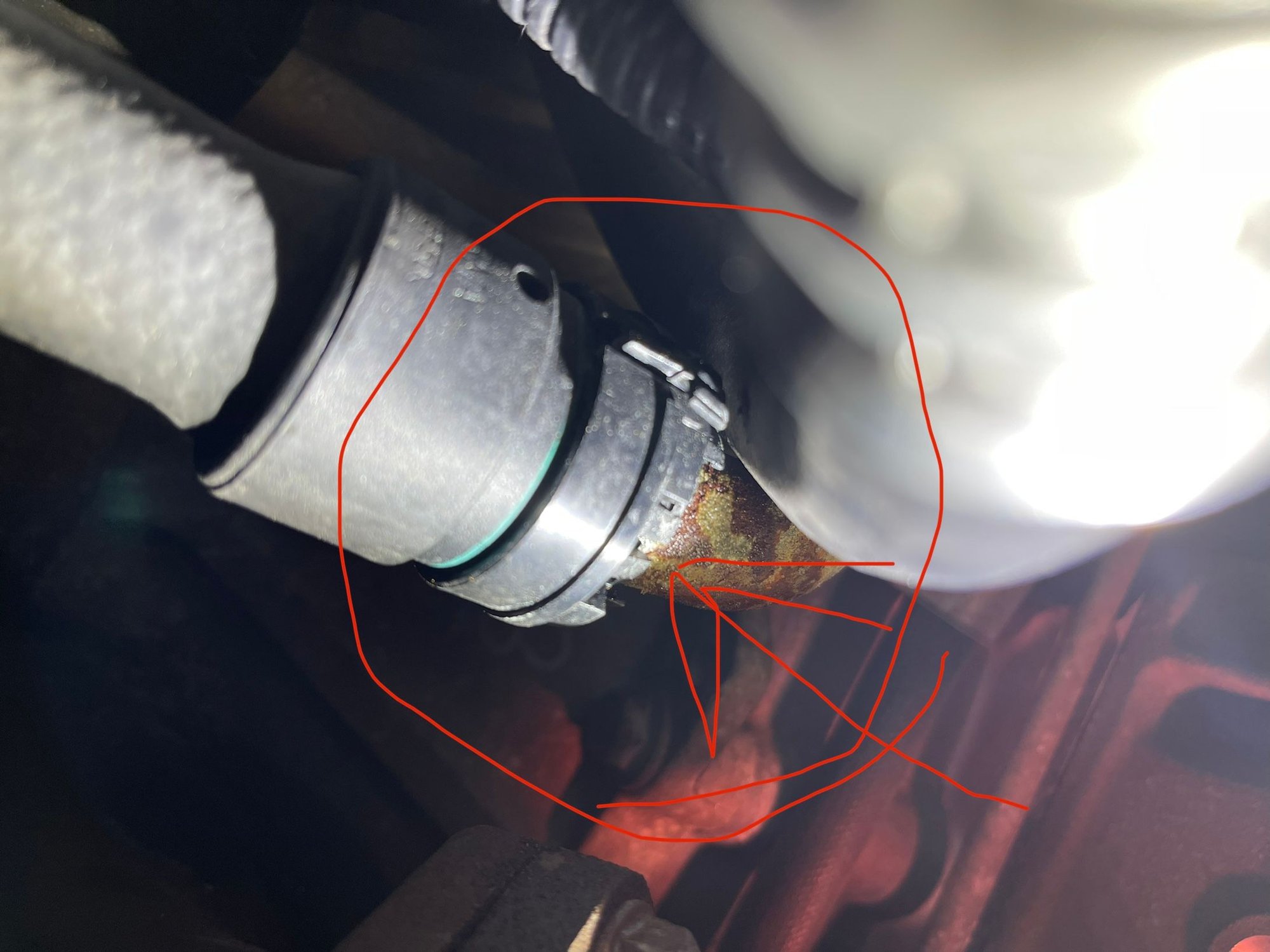

This clamp leaking right at the arrow point. The line is rubber connected to the metal curved line that connects to the large rubber hose from rear of engine.
The site of the leak. Replace coupler?
As viewed from passenger side looking down to rear of engine down thru the jumble of A/C and heater hoses.

Replace it with an all new one. MNC6733AE is the part number.

Also replace the heater hoses under the intake manifold and the three way connection on the other side while you have it off. Stay with genuine Jag parts.

The plastic “Norma” clamp is part of the octopus. You might be able to engineer some kind of fix but I think I would replace the entire octopus. The metal pipe going to the rubber hose which runs in the V of the engine under the intake is probably corroded and might be the real problem.

As mentioned, the Norma hose clamp/attachment/Mickey mouse making me look stupid configuration, is in poor condition. Brittle, appears broken, but also swivels freely as it attaches to the metal line from engine. Searching for information on this clamp results in zero help. How does the clamp work? Push/pull? Click on and tabs to push to pull it apart? Magical incantations? I bought the O-ring and came home to start the repair, but it stumped me.

PARTS GEEK had them a while ago for a little over a hundred dollars.
https://www.partsgeek.com/catalog/20...ater_hose.html
The GREEN plastic insert is DISCARDED and the plastic sliding lock is moved FORWARD to fit the part to the steel pipe.
To remove, the collar needs to be slid AWAY from the end to release the 'locking fingers' from the bulge in the steel pipe.

Under $15. Length of 3/4 hose, 4 clamps cuz they came 2 to a bag, one 3/4 insert to attach the hose to the one I cut off. Then I cut the offending hose at the offending coupler, snipped the coupler until it gave in to my assault, cleaned off the rigid pipe and slipped the two hoses together and clamped them down. Then slipped the rubber hose over the coolant pipe, and clamped it down tightly. 15 minutes. We are about to go take the drive to break in the 02 sensor, and hope that the dash warnings will reset. It idles smoothly, sounds amazing, and has no leaks. Crossing fingers.
