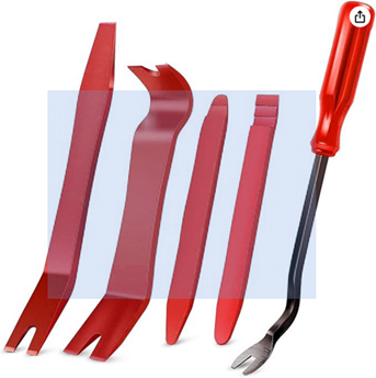

You are more than likely not just tightening things up, you will be dealing with sun dried cracked/broken mounting points. Using plastic body panel tools (easily obtainable from Amazon) you will have to take off the wood panels. The hardest to get off will be the passenger side airbag one, but it will come off as you work it and when it does it may pop off but will be tethered so as not to kill the passenger if the airbag to be deployed during an accident. Don't worry, it won't blow taking off the wood panel.
You need to be somewhat careful because you don't want to create more broken mounts. The mounting points aren't the only area sun dried, it's the whole panel, this will include the slip clip recesses that hold the wood panels on. To get the area around the radio off, put your emergency brake on, turn the key to ACC, bring the shifter back and remove the knob. Lift the shift bezel straight up, remove the retention plate, then remove the wood. You can put the shifter back in park and remove the key to stop the incessant dinging. Recommend putting a towel over the shift indicator, they scratch easy. If your interested in a custom shift knob or need wood panel repair let me know, I can refer you to a great source, he's done work for many on site here.
