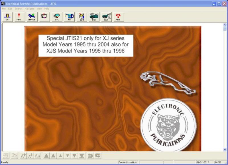

Here are screenshots showing the JTIS21 XJ Special Edited version:
First Screen that opens
